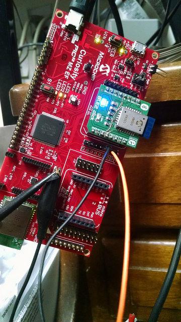

Like you said before, we code in different worlds, with different objectives. I'm just about finished re-hosting the initial machine low-level drivers (full interrupt driven with DMA I/O transfers on some devices) of a MIPS32 version of the riot-os on a PIC32 dev board. This is using the MIPS32 bare-metal compiler on Linux to cross-compile the C code and link it into a compatible hex file using IPE to flash the board. There is no PLIB, no Harmony or Microchip framework to use, only C (with a small amount of assembly), SFR defines in the device header and the riot-os API. The objective is different. What's needed on this project is to make robust, generalized and easily understandable fast code that can be reused and ported. My first test application for the new host board OS with a completely different C compiler (the mips GCC port) and CPU was the C language PIC24 RN4020 project app I posted here. After a small amount of rework (hours) on the BLE project device I/O model to match the current OS api it runs even better on the new platform.
https://github.com/nsaspook/RIOT/tree/PIC32MZEF/examples/rn4020_riot/test.X
No time was wasted. The original C application programming time was well spent when porting the code to a machine with different and better hardware features.

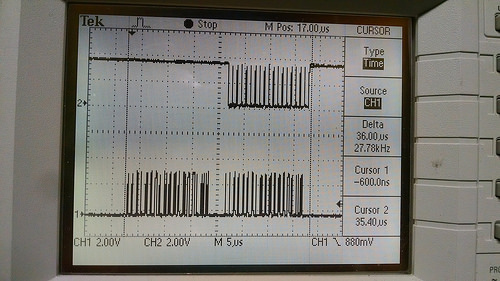

Driver CPU processing time for two SPI 18 byte data-stream channels send trace #1 and receive #2 with a 10MHz SCK.

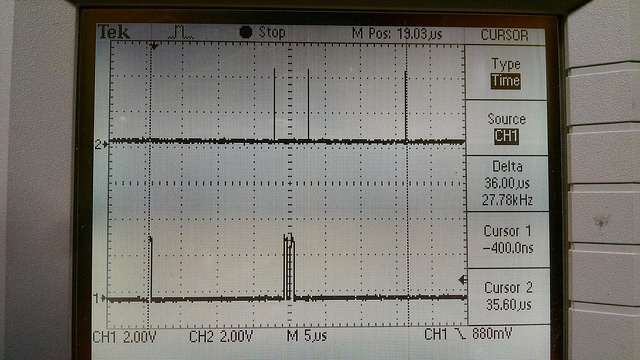

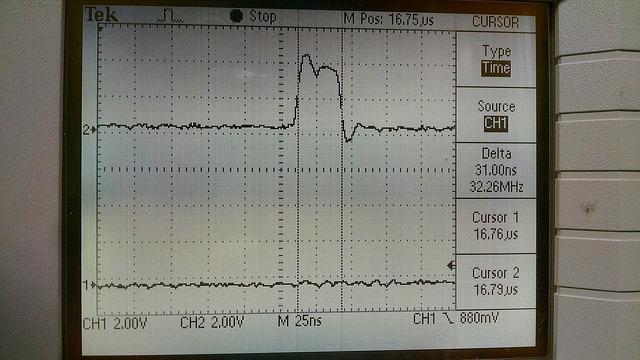

Receive ISR usage from DMA interrupt.
