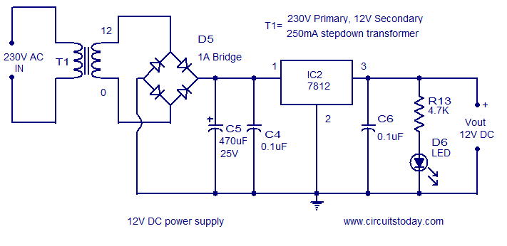

MrChips, thanks for the advice and links. I might just take your advise on building something simpler. I'm probably a bit ambitious for my experience level. :)
I think I'll try a 12V 1A. That should be sufficient for 90% of the projects I have in mind.

Yes. The first supply I ever built as a teenager is a simple 5V@1A supply using a 7805 three-terminal regulator.
I still have and use this supply once in a while.
