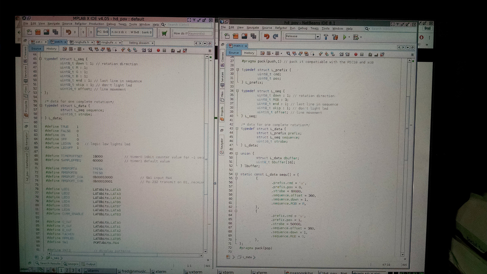

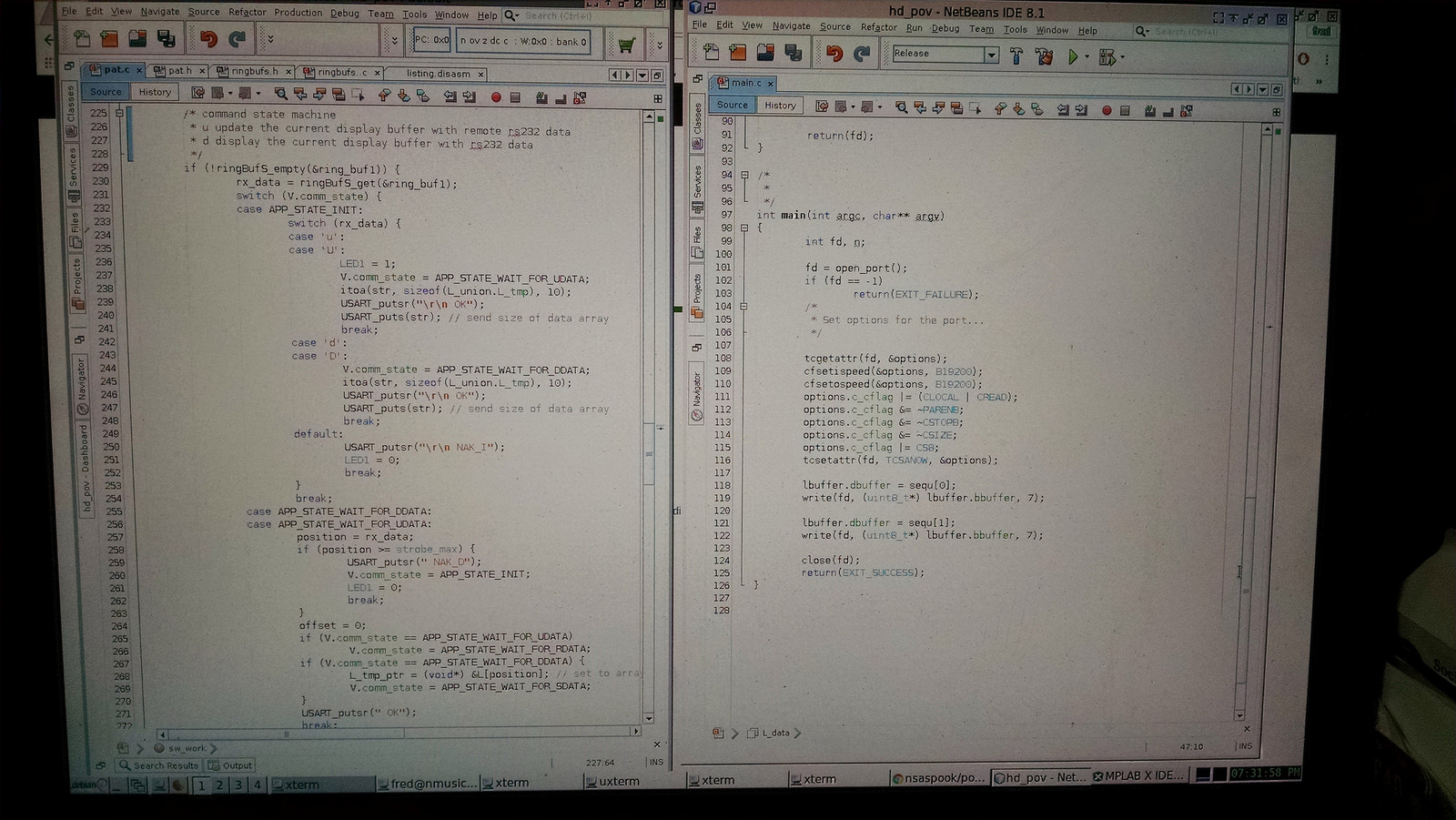

The generic bit packing in C is implementation dependent by default but there are ways to pack bits in an efficient manner if you use the C way of handling data in the design and implementation of a program.
For my toy POV display project I'm sending raw structure data with flags and sub-byte sized fields from a Linux machine to a PIC18. XC8 uses byte alignment for C structures because it's a 8-bit chip but most 32/64-bit x86 machines default structure alignment is to pad for efficient memory access by adding byes. It's very easy to change the default with a gcc #pragma like this.
Linux machine:
https://gcc.gnu.org/onlinedocs/gcc-4.4.4/gcc/Structure_002dPacking-Pragmas.html
#pragma pack(push,1) // pack it compatiable with the PIC18 and xc8
define structures
#pragma pack(pop)
MPLAB X with xc8 on the right, Netbeans with gcc on the left. Easy to see where MPLAB X is from.:D It's very easy to initialize sequ data using the IDE for each flag or field on the
common (they could have been defined in a separate file but this is a simple example) header typedef'd structures.
The Linux code just sends a few command sequences for testing the protocol via rs232 from the sequ union structure/byte array to the PIC18 command state machine to change the current display lines as seen below.
