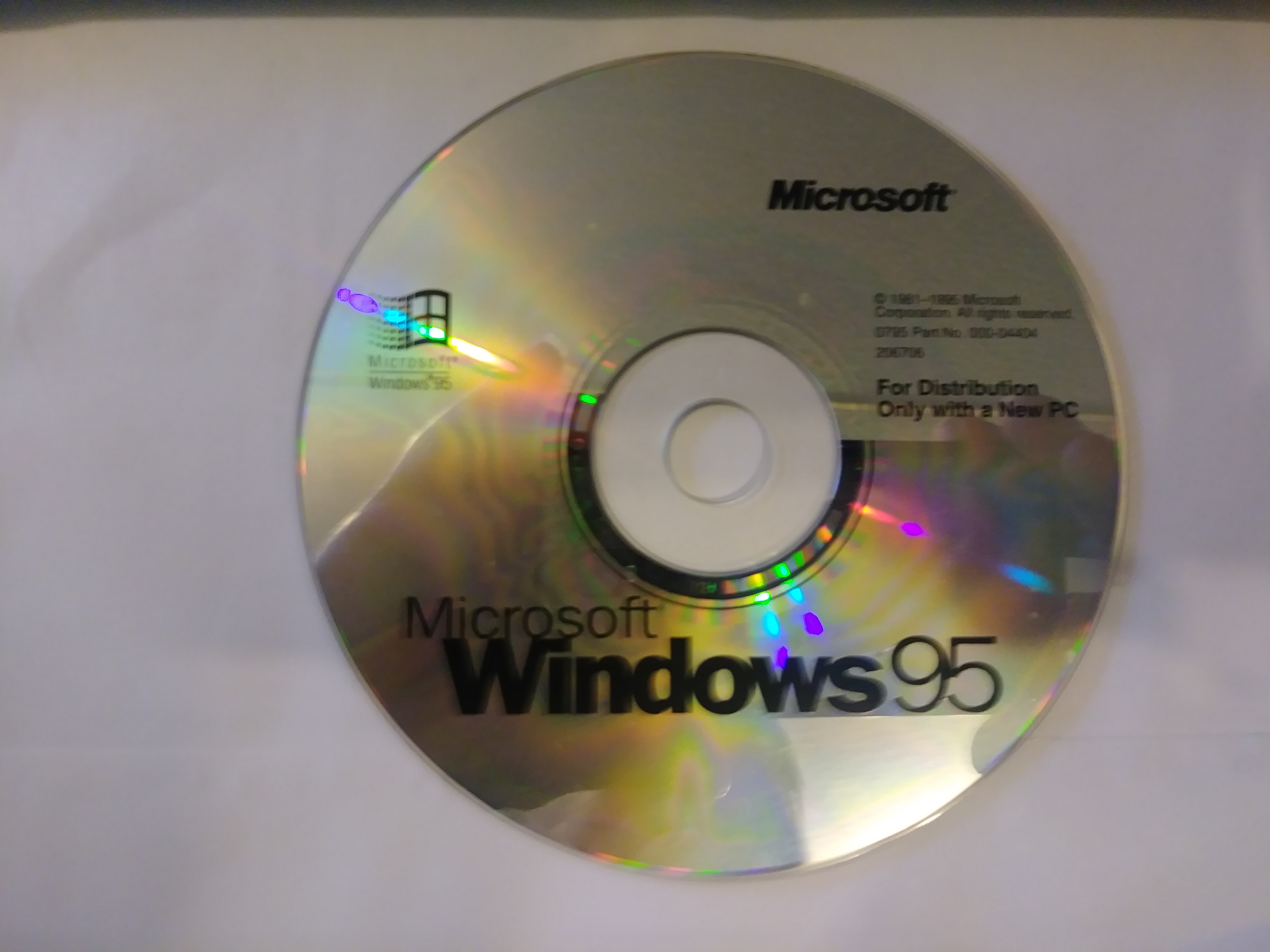

After posting with @KeithWalker in another thread I've always wanted to dual boot my computer to an older version of windows so I can put some of my older programs back on my computer. After looking for awhile I found a Win 95 disc. But when I try to boot from it I get the error "No Bootable media found". It's an actual Win 95 disc with product key and all. Running win 10 now.
Any advice

It's a full install. I recently (About 5-6 months ago) Had to replace my hard drive and I'd already made an win 10 reinstall disc and it worked just fine. This old computer came with win 8.0 so I upgraded as soon as I could to 10. It's so old that to get it to boot from a disc you have to go in the bios and change the boot setting from UEFI to CSM to even get it to recognize the disc. It recognizes there is a disc but says it's not bootable.

If I recall (I may be wrong), Win95 CD was not bootable, they relied on a bootable floppy to get things started, then you ran a setup file off the CD.
You can probably get by with any bootable "DOS" type of device, even a USB stick with something like FreeDOS. The run the Win95 setup off the CD.

Your Right @sagor. I totally forgot about DOS ? It loads a generic CD driver to allow WIN 95, 98 and I think ME to be installed.
Have all that somewhere, now back to the boxes and boxes of discs.
Thank God I own a USB floppy drive.
