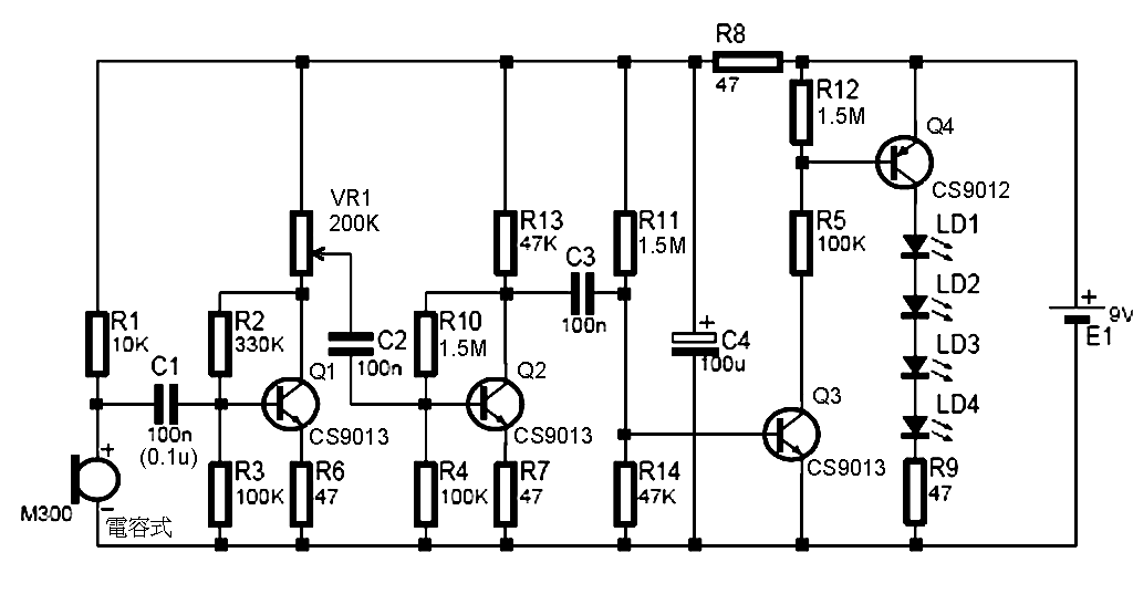

    So I'm wanting to make a lightning system for my PC, that is controlled by the sound of the speakers. The problem is I can't find out a circuit that could do this for me,
    When the Sound is Loud the lights become more brighter/intense, when the sound is low the light become dim,
    I know to use a NPN transistor, cuz a relay will only work as a switch. But will the NPN BJT fill up my condition. I will be experimenting on a speaker and using the current from the wires connected to the speaker magnet as my source of the transistor... Help me out

  4. ScottWang
    Moderator
    Aug 23, 2012
    6,459
    1,001
    Sound control LED - 4 bjts and some RC, the original contents is Chinese Version, but I used google translation to translate the page to English.
    [​IMG]

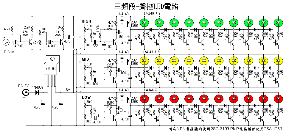

    Here is another one.
    [​IMG]
