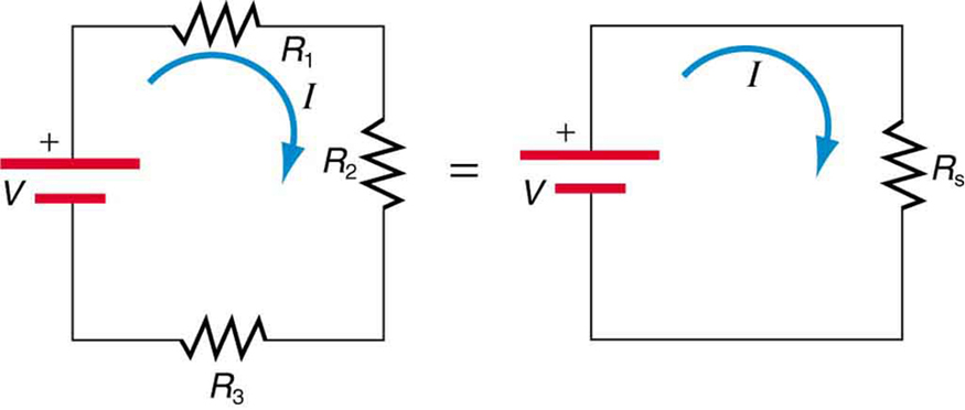

Take three resistors R1, R2, and R3 connected in series with a voltage source.
The only formula you need to apply is Ohm's Law,
I = V / R
The current in the loop is I.
The voltage across R1 is I x R1.
The voltage across R2 is I x R2.
The voltage across R3 is I x R3.
The sum of the voltages across each resistor must be equal to the voltage source V.
V = I x R1 + I x R2 + I x R3
V = I x (R1 + R2 + R3)
In other words, we can replace R1 + R2 + R3 with a single resistor Rs.
Rs = R1 + R2 + R3
Hence
V = I x Rs
or
I = V / Rs
End of story. No water analogy required.

V=2, R=300, so I = 0.006 something?
When I press the A on the multimeter, is say 16.7mA. Is that the current draw of the LED?
Ya’akov
Joined Jan 27, 2019
10,370
When measuring across a component, you are measuring the voltage drop across that component. While all the drops must sum to zero when you get back to the start of the circuit, each one will be it's proportional share.
Each drop is depends on the resistance, so you can, for example use E=I/R to determine the resistance of the DUT (Device Under Test) if you know E and I using R=E/I.
That 1.99V you are seeing is the voltage that results from the share of power consumed by the component as part of the circuit.
Does this help? I am not completely certain about the crux of your confusion.

Voltage across a component
It will pay for you to note that a voltmeter has two leads, a red lead and a black lead.
Voltage measured is always "across a component". It is not voltage at a component. (People sometimes do say this. I will clarify this in another post.)
Voltage measured is always a voltage difference between two points in a circuit. That is why you have two leads on the voltmeter.
It is the same as measuring distance between two places.
Asking "What is the distance at Melbourne?" makes no sense.
A proper question could be "What is the distance between Melbourne and Sydney?"

Current through a component
In contrast, current is always a measurement through a component.
Ammeters are usually protected by an internal fuse, typically, a ½A fuse.
It is common for newbies (and pros too) to blow the fuse at least once in their life.
Why does this happen?
The fuse will blow when you inadvertently try to measure voltage with the DMM set in the current measurement range.
It also happens when a newbie doesn't know how to take a current measurement.
In order to take a current measurement you have to break the circuit and insert the DMM leads to reconnect the break.
In other words, the ammeter is placed in series with a component.
Voltmeter goes in parallel with a component.
Ammeter goes in series with a component.
