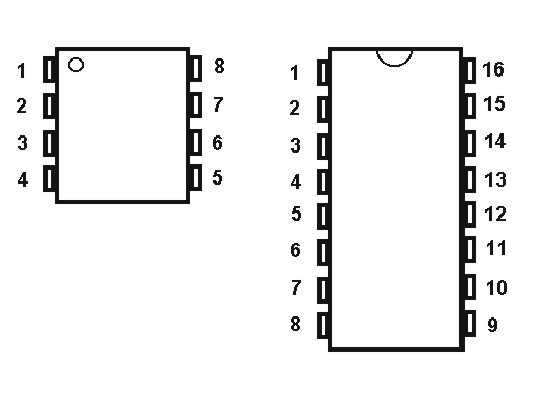

Just noticed your pin numbering on the bottom view is wrong. In integrated circuits, with a very few weird exceptions, pins are numbered consecutively going counterclockwise from pin 1, as viewed from the top. So, an 8-pin dual In-line package (DIP in North America, DIL in the UK; Chinese vendors on ebay tend to call anything that has through-hole pins DIP) is pins 1-4 down one side, the 5-8 up the other - pin 8 is opposite pin 1.
You have to be careful if pins are "missing" as sometimes happens where a pin is omitted to make a wider gap if high voltage is involved. Usually the omitted pin position is numbered as if there were a pin there, but not always. Not many ICs are made with omitted pins but they aren't really rare, either.
