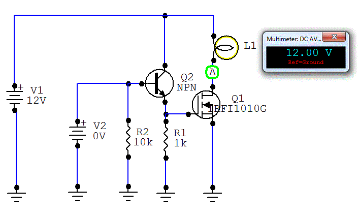

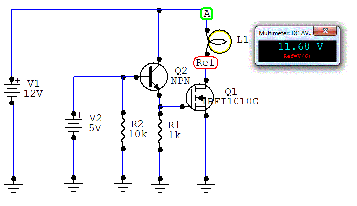

Take a look at this...
Circuit is either on (+5v logic signal on base of NPN) or off (0v logic signal on base of NPN). Note the voltage drops on the bulb and mosfet in each case. Note that power dissipation is maximum in bulb, minimum in mosfet, and non-existent in the off condition.
On:
Off:
Note that you can build THE SAME CIRCUIT AS MANY TIMES AS YOU WANT and, as long as your +12v source can supply the current, you can switch on and off as many light bulbs as you want independently. You just need one circuit per bulb and a corresponding on/off signal.
Get it?

Hi PaulEE
Thanks so much for the suggestion.
My problem is that I can't get access to the ground wire and have to have a high side switch.
Do you know of a way to do this w/o using a PNP mosfet?

Hi PaulEE
The term "PNP" is used for bipolar transistors. It's "p-channel" MOSFET.
To use a n-channel MOSFET as the one you have the gate voltage needs to be higher than the supply voltage, therefore you need a charge pump (high side driver).
12V over the load connected to the source, means you need another 12V to drive the gate, the gate will then be 24V over gnd and 12V over the source voltage level.
There are suitable PMOSFET available on digikey.
