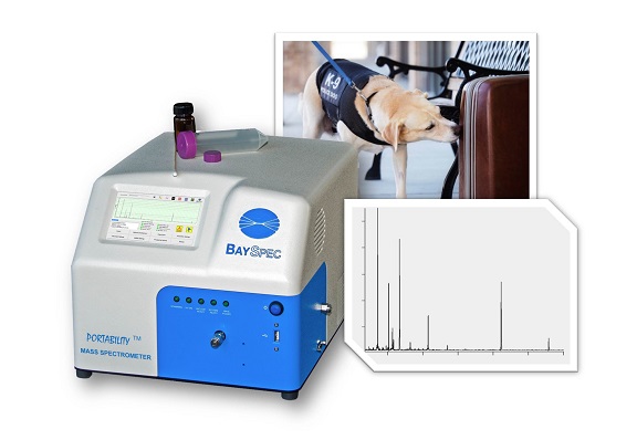

Danko
Joined Nov 22, 2017
2,256
Buy portable mass spectrometer. It is exactly what you are trying to find.
Edit: Military grade handheld mass spectrometer (PDF)
For example, one more:
Portability™ Transportable Mass Spectrometer
Overview
The PortabilityTM mass spectrometer is one of BaySpec’s newest portable instruments. Designed to bring the benefits of MS chemical analysis to the field, the PortabilityTM can service a variety of bulk or trace detection applications with its compact form factor and intuitive user software. Small enoughto be carried by one person, the PortabilityTM is compatible with in-situ and direct analysis techniques.
Key Features
  • ppb-level detection
  • Person portable with battery power
  • Linear Ion Trap Technology
  • 17 lbs., 13 in × 11 in × 9 in

A portable, or non-portable, mass spectrometer is typically used to detect residual vapors from materials. Usually the vapors are not in the form of charged ions. Mostly the vapors are from organic (carbon based) compounds, seldom including metallic elements. The vapor pressure of most metals is low enough that they would not be detectable at any reasonable temperature. Mercury may be an exception, I am not sure.

@styven: Honestly, you do not need any ions, microvoltmeters and so...
You trying to find metals, right?
Concentration of metal in soil is quadrillions times more than it can be in air.
Simple take soil sample and put it to mass spectrometer.
If you do not want to own mass spec, send samples to laboratory, as geologists usually do.
Detecting Trace Metals Using Inductively-Coupled Plasma-Mass Spectrometry (ICP-MS)
