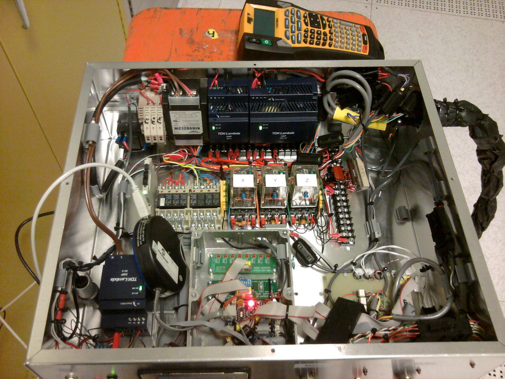

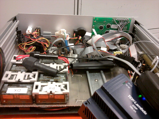

16,474
Ferrite filters on the load and signal lines work wonders for pesky mcu reset and hang problems when driving inductive loads. Proper grounding and shielding are also important.
PIC based XYZ motor tester prototype with motor control relays and filters.
For production unit one I mainly used snubbers under the relays but had to retrofit snap-on ferrites in a few locations for 100% stable operation in the new design.
The Wolf whistle sound effect are resets.
https://github.com/nsaspook/mandm/tree/master/mandm
