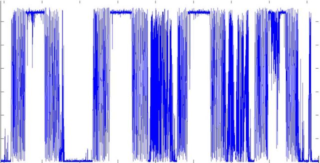

I connected a potentiometer to the ADC and turned it both directions for eight times to monitor the output through Putty.
I tried the following code:
C:
#include "mbed.h"
// Initialize a pins to perform analogue input fucntions
AnalogIn   ain1(p15);
AnalogIn   ain2(p16);
AnalogIn   ain3(p17);
AnalogIn   ain4(p19);
AnalogIn   ain5(p20);
// USB serial (TX, RX)
Serial pc(USBTX, USBRX);
int main(void)
    pc.baud(115200);
    short ADC1_voltage;
    while (1)
        ADC1_voltage = ((ain1.read_u16()&0xFFF)*3300/4095);
        // Send the five ADC values to serial port
        pc.printf("%d\n", ADC1_voltage);
and got this plot:
Then I replaced the the same code, but this time using a floating variable:
C:
#include "mbed.h"
AnalogIn   ain1(p15);
AnalogIn   ain2(p16);
AnalogIn   ain3(p17);
AnalogIn   ain4(p19);
AnalogIn   ain5(p20);
int main(void)
    pc.baud(115200);
    short ADC1_voltage;
    while (1)
        pc.printf("%d\t,%d\t,%d\t,%d\t,%d\n", ADC1_voltage, ADC2_voltage, ADC3_voltage, ADC4_voltage, ADC5_voltage);
and got the following result:
As can be seen, the results are not correct when using integers. Any suggestions of what can be wrong?
In the code ADC_int = ((ain1.read_u16()&amp;0xFFF)*3.3/4095); , do I have to keep the "amp;" ? because the program was not compiling with it included in the code.
Thanks in advance.

jjw
Joined Dec 24, 2013
823
What is amp?
Don't mask the result with 0xfff, 0xffff is ok, if needed.
This should be ok:
ADC1_voltage= (ain1.read_u16()×3300)/65535;
djsfantasi
Joined Apr 11, 2010
9,237
An unsigned integer type has a maximum value of 65535. Since you are multiplying the ADC value by 3300, the ADC value cannot be greater than 19! Otherwise you will have overflow errors. Cast your input to an unsigned long and multiply by an unsigned long (3300ul, or however it is represented in your language). Divide by an unsigned long and then cast the entire calculation back to an unsigned integer.
You can even use integer arithmetic to get the result, and use this technique to obtain a floating point value in volts.
Calculating with mixed types and using division with integers can often be problematic. You have to consider the range of intermediate results. The technique I explained is an example of how I code to get around these limitations.
