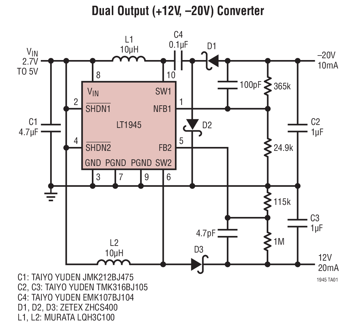

    Was hoping for some help adapting this circuit from +12V / -20V to +5V / -20V.
    Are the two resistors on the +12V side the only components that will need to change?

    1,114
    335
    Replace 1 MOhm resistor to a smaller resistor. Approximately 330 - 360 kohms. Use the LTspice.

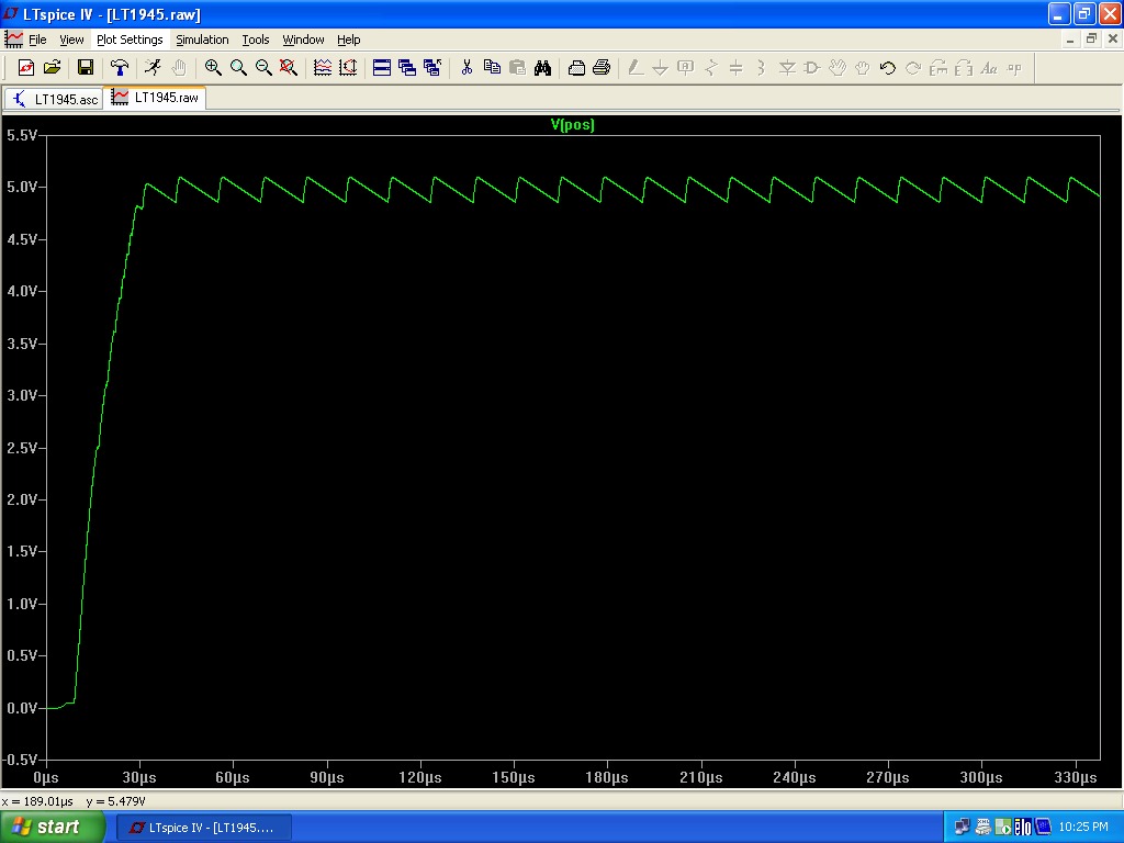

    Tried that, and instead of a steady output voltage I end up with this sawtooth wave:

    1,077
    Try larger filtering caps and/or larger inductor.
