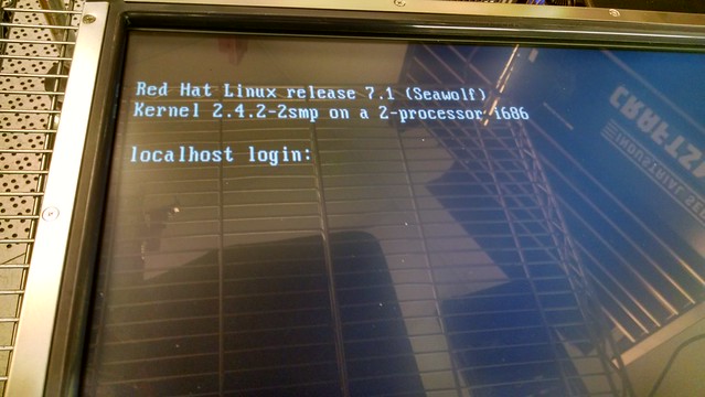

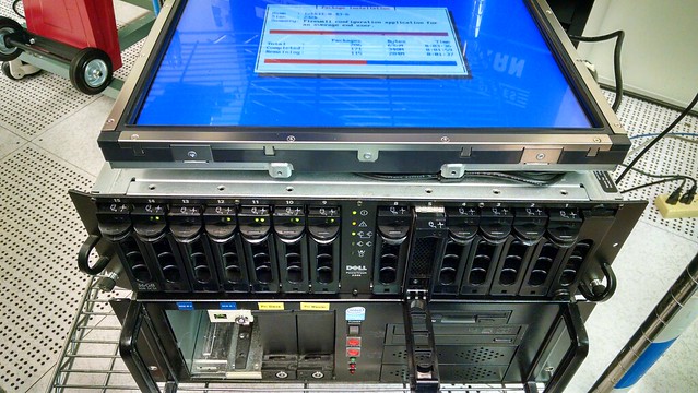

I ran a little test to see what old Linux versions would still boot on an old PC once used for machine control.
Slackware and RH 7.1 from my Linux distro cd archive passed the test by detecting and setting up the SCSI controller correctly.
