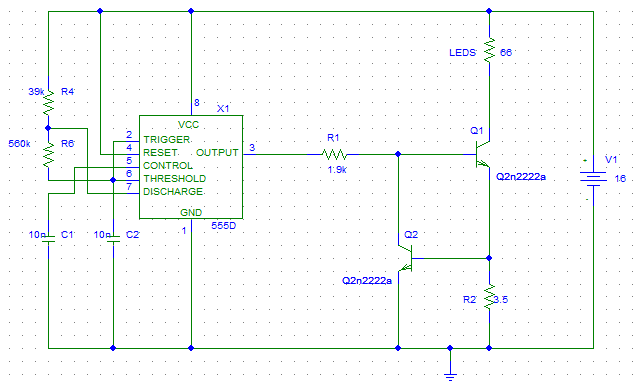

What "danger" are you referring to?
The Hfe will have only an minor effect if you use an emitter feedback resistor to control the transistor current and the typical transistor current-limit circuit has (did you look up those type of circuits as I suggested?)
i was told by a coleague that the Hfe of the transistor can vary so if i dont use the opamp, the current in colector may go upper than maximum value. Maybe he is wrong.
I looked and i found some interest stuff like this for example (http://www.physics.unlv.edu/~bill/PHYS483/current_lim.pdf), tomorrow i will try it, thank you for suggestion
A typical opamp can source around 25mA. A base resistor could accomplish the same thing. Beta variations would result in more or less base current, but the current in your driver is controlled by the transistor emitter resistor and the forward voltage of the transistor BE junction. That voltage varies with temperature and current but that would happen regardless of whether the transistor was driven from an opamp or a resistor.

Ok so it seems the problem of previous circuit really was the opamp not being able to buffer the signal fast enough, so i decided to change circuit to this:
Im sorry the timer is not more clearer but i dont know how to change package pins in my simulator.
I think this way it will work, i changed the opamp for a simple current limit circuit as suggested. In simulator everything works good, i will need a dissipator for Q1 but other than that i think this is the best.
Thank you all for help. If you have any suggestions about this circuit feel free to say so.
