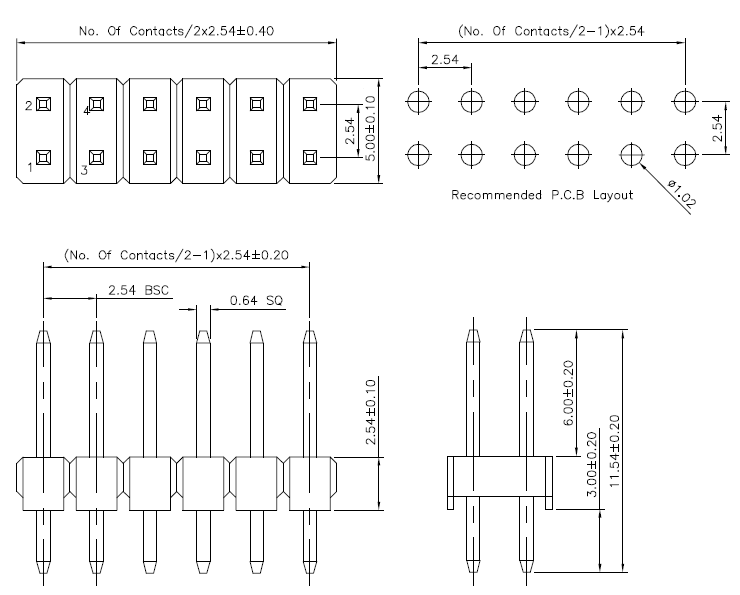

Tired of 7segs I bought a LCD. This one over here
now you see the connections to the right....? How do I connect this? Ultimately I want to connect this to a board but in the meantime I also want to connect it to a breadboard.
Now I think the most elegant solution would be something like
However I dont have that kind of connector :confused:
Another option is the "Pin headers" but you see these 2 rows of pins? they are so close to each other it is not possible to connect it to a breadboard:arghh:
Any suggestions...?

I think the TS's problem is that the row spacing on the display header is .100" and the breadboard spacing between rows is .300". If you buy them with long tails, you can put a Z bend in the long ends of the headers @nsaspook shows to make the spacing fit the breadboard. You also could use a piece of .100" perfboard to mount one row directly and the other spaced 2 rows over and add jumpers as required (some perfboards have several holes connected together, that would help).
These and these headers have longer (.318") tails to give you something to work with.

Or you can do it like this:
I've soldered a 10 pin header on a strip board, and used short wires from the board to the LCD.
PIN OUT
1 -> GND
2 ->VDD
3 -> POT
4 -> RS
5 -> RW
6 -> E
7 -> D4
8 -> D5
9 -> D6
10 -> D7
This fits perfectly on a bread board.

Given a solderless breadboard... one could always solder on insulated solid bus wires and dress each one into the correct breadboard row. Something to mechanically hold things in place would be a blessing.
As far as the code to drive these, look over the multiple threads on this very forum for other people driving these. I've yet to see one of these that doesn't use the extremely common HD44780 chip (or clone) to drive them. Google "HD44780 code" or "LCD code" will bring up lots of hits.
