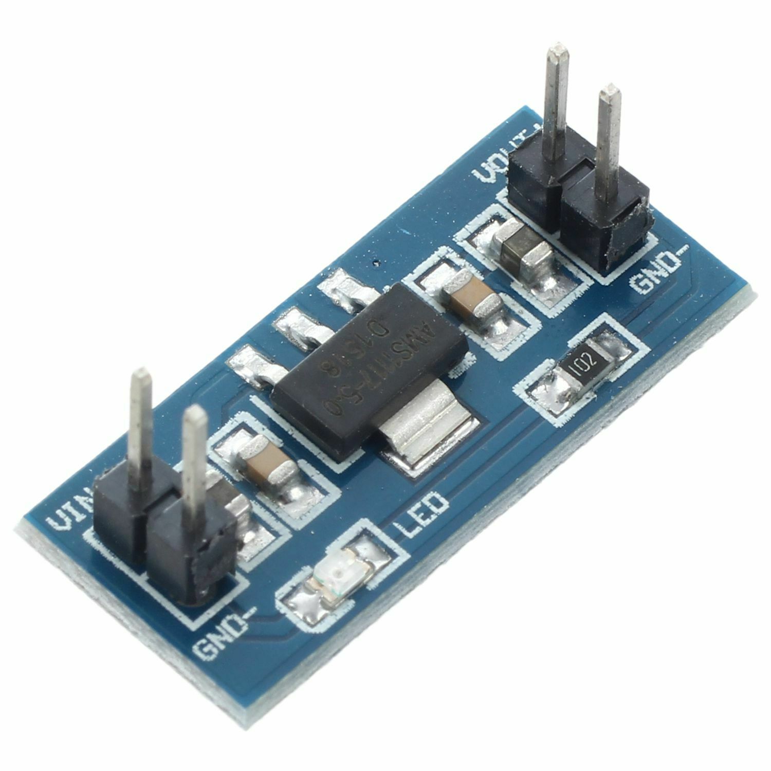

Would the circuit be the same as the one I posted but instead of the LM7805 its the AMS1117-5. Or do I connect it directly to the IC.
This is the data sheet for the AMS1117 which shows the pinout. The pinout is not the same but yes, the circuits would be the same. I would also do as suggested and put a 47 Ohm resistor in series with the LASER, I also played around with them and on 5 volts they have a short life. On the regulators pay attention to the package.
Since you mentioned using an Arduino unless distance precludes it you could use the 5 Vout on most Arduino boards to power the laser still using a 47 Ohm series resistor.

I will be using it on a track and the laser will be on one side and the LDR will be on the other side with the arduino so I can't use cable to connect arduino output to laser.
I found this board, but don't know if it's wired correctly because I don't see the diode
If not then I will create my own regulator circuit using that circuit in my latest post by move the resistor from in series with the diode to in series with the laser.

That board should do fine. Diode D1 in your circuit and similar circuits are there only as added circuit protection, normally a common 1N4001 is used. They are not required so don't always expect to see them.

There is difficulty in getting a through hole AMS1117-5 component.
i'm starting to think of getting a dc-dc converter board which has the ams1117 board on it like i posted above. Just add a 47R resistor in series with the laser.
Description:
Input: 6V~12V DC (input voltage must not drop below 6V).
Output: 5.0V 800mA (load current must not exceed 800mA)
Can be directly soldered on to PCBs using the pre soldered pins.
PCB size: 2.5cm x 1.1cm
Comes with onboard power indicator LED (red).
