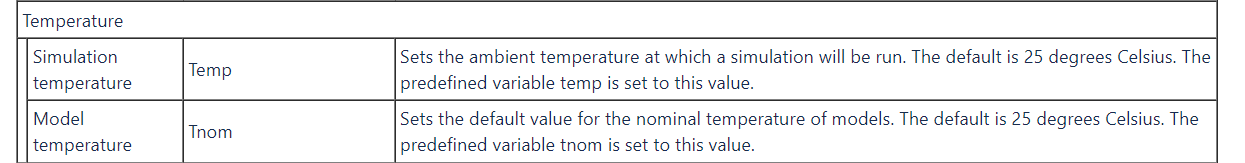

thank you!, but where do I find the place where I can change the parameters on the ADS interface?
it does not say where to change it, only providing the list.

I am using Keysight ADS simulation options
What is the difference between simulation ambient temperature and nominal temperature of models?
You can use the model temperature for devices that are self-heated significantly above the ambient temperature, such as power diodes, resistors, or transistors.
