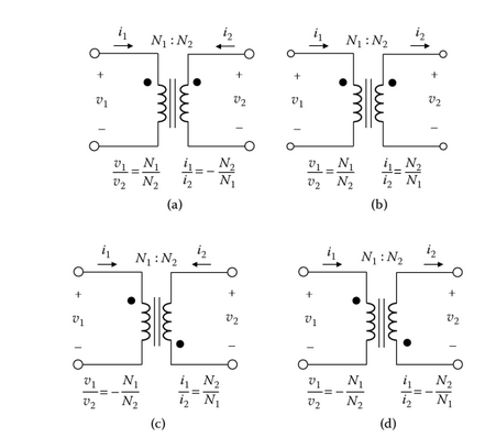

I think this may be the model you are referring to. However, I don't see how inductors are eliminated for ideal transformer k = 1.
This book also gives many models and as in the figure d, inductors are eliminated for ideal transformer. I don't understand why figure c and d are equivalent.

Hello again,
The inductance gets eliminated because the frequency goes out of the expressions and just leaves inductance value ratios which is not inductive anymore because Henries/Henries equals a dimensionless constant, and that happens because M=sqrt(L1*L2) when k=1.
A real simple example would be with no load, the transfer function:
Vout/Vin=s*M/(s*L1-s*M+s*M)=s*M/(s*L1)=M/L1, which is no longer frequency sensitive just the ratio of two inductor 'values' which is no longer inductive.
A second simple example is with a resistor load, and because M=sqrt(L1*L2) all the terms with frequency in it disappear.
Try it once for kicks, it's worth seeing. This is with a single resistor on the output like R2 as the output load. You can also try with a series input resistor R1, see what you get.
It makes sense though because if it was frequency sensitive it could not be ideal. But it's worth looking at...see if you can find an anomaly.
