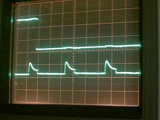

The bottom trace (top is a signal gate) is from a Hall sensor measuring battery current from a C40 PWM controller limiting voltage by controlling the PWM duty cycle with a nearly charged battery.
Simple PWM charge controllers like the old C35/C40's run at a few hundred Hz.
We see a steep increase in current as the PWM switch turns on the battery to full panel voltage, a quick drop in current as the panel voltage quickly drops from the increased battery load with current leveling off due to nearly charged battery chemistry and then off to repeat the cycle.

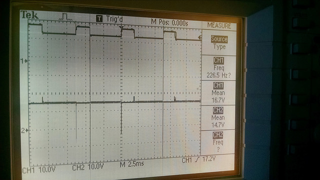

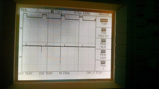

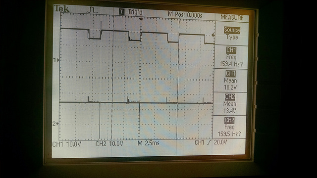

Needed to make some hot weather (~100°) adjustments on the charging voltage.
PWM waveforms from my C40 charge controller adjusting for absorption voltage limits. At this point in the charging cycle any MPPT possible power gains are meaningless as the battery can't accept more current without raising the charging voltage above the recommended limits for flooded cells. MPPT could have shortened the time it took to get from completely discharged to this point by maybe 10-15 percent over the entire bulk, absorption, float cycle.
Scope traces
Top: Panel voltage at input terminal
Bottom: Battery voltage at output terminal. The negative going spikes from the several foot battery wire inductance when the ~30A current switches off and the magnetic field collapses is a major reason to keep the PWM switching frequency low.
Battery charging voltage is lower due to temperature adjustments in the controller.
Float
