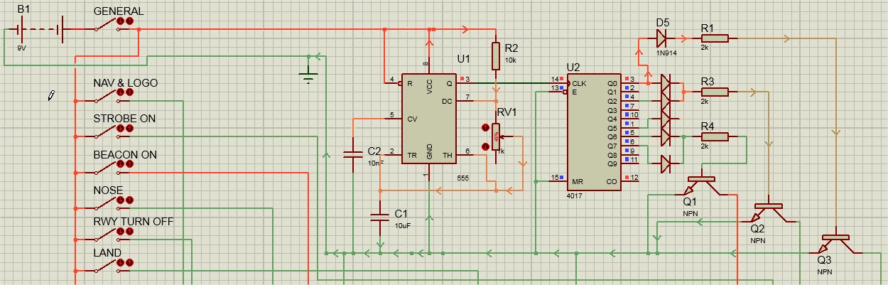

Hi! After a lot of work and help from guys on this site, I could make my first circuit.
Now I'm looking face two problems that I couldn't resolve because I'm very noob, but maybe here can helpme a little (thanks in advance!)
My first problem
is the switch isn't working with this configuration. I tried to turn off the 555 power supply but I think is taking it from negative pole (pin 1). Even more, If I took off the GND, the simulation fails.
The second one is that I've 8 switchs, and because the circuit is far away from switchs and power supply, I'll need at least 9 cables to connect the control panel and the circuit. This can be done with 3 cables, or something like, I mean... 1 PWR, 1 CTRL and 1 GND? What do I need? With an idea I'll manage myself to look up in internet. I was also thinking in something like RF to switch but I don't know..... Thanks a lot in advance for any help/idea! :)
wayneh
Joined Sep 9, 2010
18,169
My first problem is the switch isn't working with this configuration. I tried to turn off the 555 power supply but I think is taking it from negative pole (pin 1). Even more, If I took off the GND, the simulation fails.
Are you saying that you have problems with your simulation, or you built that circuit and have a problem with the switch? I see no power source other than B1, so disconnecting it has to turn off U1. You haven't drawn the power pins to the 4017. If this is in a simulator, it may require those.

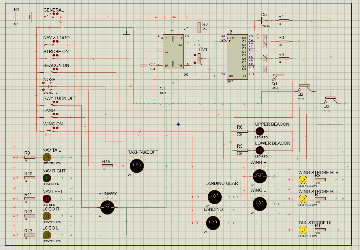

Thanks wayneh for your time and effort to understand my design!
Here there is a complete vision of the circuit, I didn't upload because I believe it was too much, but I think is better the complete panoramic.
As you can see, even when the switch called "GENERAL" is turned off, everything is working, leds, 4017, 555, etc.
Thanks in advance and sorry by my poor knowledge!

Thanks Wendy. And wayneh. Both right! I'm seeing Proteus options and it seems to be the power rails configuration of the soft. There is any good simulator in order to make this circuit as "real world" ? Thanks!
Simulators need to have some point in the circuit designated as GND, for use as a reference point.
LTspice (and I assume Proteus) just assumes that digital IC supply pins exist, so the digital IC models don't show them. You may need to specify ".param Vdd=12", for example, if you want to use a CMOS supply voltage other than the default 5V.
Edit:
How does Proteus recognise if switches are opened or closed? I see notheing in your schematic to specify switch state. If the default is 'closed', then that would account for your GENERAL switch not working in the sim.

You may want to isolate just a battery, switch and lightbulb, so that you can work out how those simple elements function in Proteus. Make the switch work to turn the light on and off.
If the 4017 can see power without the rails connected, perhaps this default is being applied to the 555 as well.

Thanks a lot to all for your time and considerations, really, it helps me a lot!
I'll investigate this deeply. At least now I understand is a simulator problem, not design.
