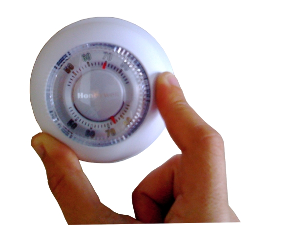

wayneh
Joined Sep 9, 2010
18,133
You need a thermostat. You can very easily get good temperature control with a simple on/off thermostat, just like your home furnace. By "good" I mean ±0.5°C or less. But you must have something to sense the temperature.
It's possible that you might get a satisfactory result with a constant current or voltage supply, once you have carefully calibrated your system. You have not told us what your system is or the precision required.
As already noted, the biggest problem with a TEC is removing heat from the hot side. You need a heat exchanger and usually forced air convection. CPU coolers are commonly used.
