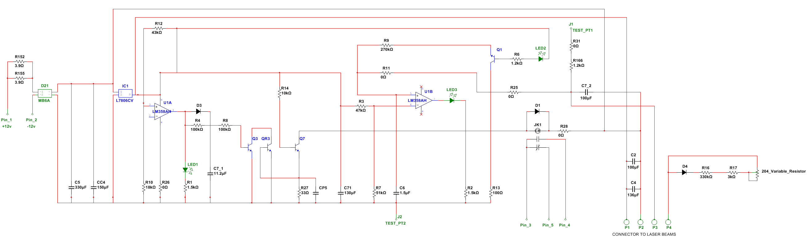

Finally finished putting together the diagram for the board I am working with.
It should be accurate however this was put together yesterday evening and this evening after 11.5 hours shifts at work.
I have tried to make sure all values are actuate however most of the capacitors I had to measure in circuit.
The markings on U1 state LM358 however the closed thing I could find in multisim was the LM358AH.
Q3 and QR3 are L6 transistors, Q7 is an S8050 transistor.
Pins 3, 4 and 5 are the signal coming from the alarm panel and then returning when the relay is energised via the breaking of the laser beams. You can choose whether you would like to have the circuit NO or NC.

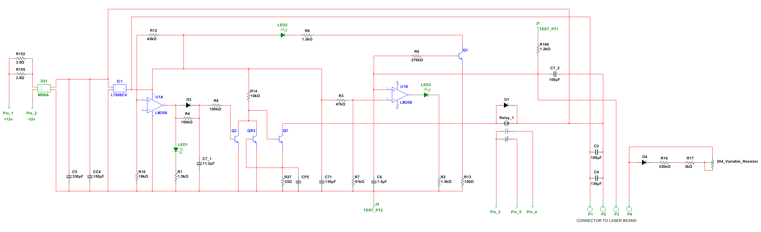

Thanks for pointing that out...will get there in the end lol.
New image below.
Q1, QR3 and Q7 are all correct as per the drawing. Please bear in mind I haven't designed this circuit I am just trying to modify it.
Thanks

I have found another error in the drawing...this is getting a little embarrassing now. I will upload another one when I am certain there are no more errors.
