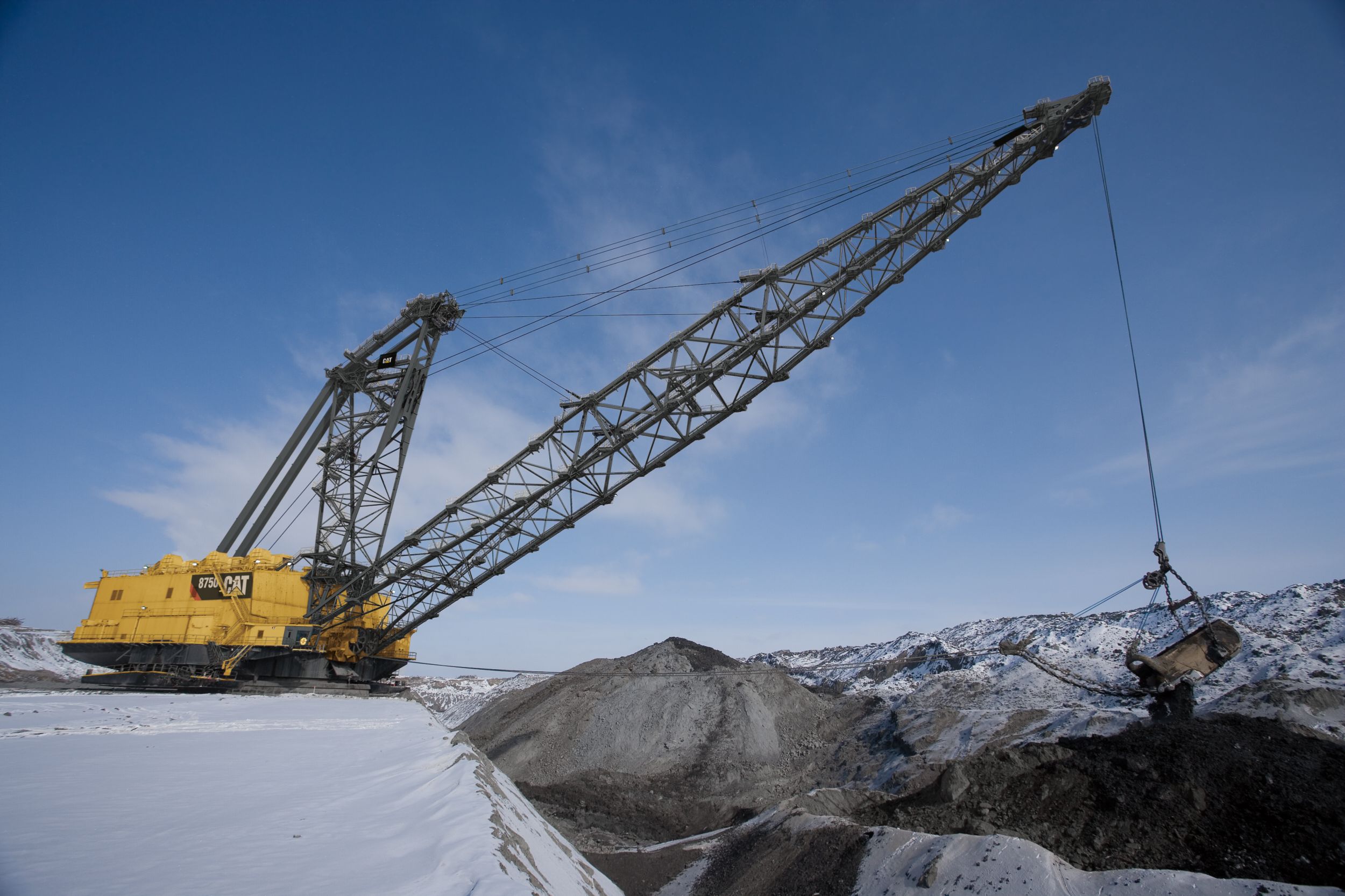

Hello Everyone, I’m never around here and the circuits world. I have done a lot of 12v projects in my lifetime working with a lot of automotive stuff and big into Solar now. I need some help on a model project where I’m getting to the electronics side and I’m lost. I was going to make this project RC but decided it’s size and how realistic it is I’m going to do a 110v power source transformed to 12v for ease of motors, lighting ect... so let’s dive in with some info for you guys.
I work in a coal mine running heavy equipment. I run what they call is a dragline, it is a huge piece of machinery that is a cable driven machine that digs out overburden. I want to build a scale model that operates for self enjoyment and it’s a hobby. Here is the machine: http://s7d2.scene7.com/is/image/Caterpillar/C765894?$cc-g$
I want to use a joy stick type like this: https://m.ebay.ca/itm/4NO-4-Positio...870307?hash=item236ce60923:g:8wsAAOSweWVXdh2b
For motors I want to be able to use any 12v motor just off of eBay that will be able to power my machine. I will need to run 3 of them for the actions of the machine. There will be the 2 joy sticks. Now what I’m looking for is speed controllers to give those motors forward and reverse functions as well be able to control speed on them all from the joysticks.
