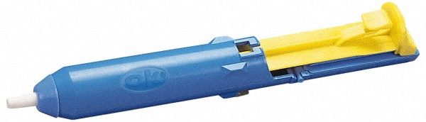

The blade are 30 in a roll but it really not a big job to replace them with something else
2 roll headers would work.
Just take your time with a solder sucker
And a good 40 watt iron try it on a old broad remove a bunch of resistor to get the hang of how to do it.
