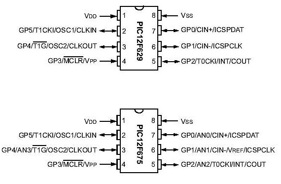

    Could U1 be some sort of PIC? It appears to have three programming pads (in addition to Vcc and Gnd).
    I've attached a picture of the circuit. The red line is permanently connected to Vcc and the light blue to Gnd.

    I agree, it looks to be some type of microcontroller with 3 programming pads.
    It could be a PIC 12Fxxx series, the 3 programming pads correspond to MCLR, ICSPC, ICSPD.
    Also the top pins 1 and 8 correspond correctly to Vdd and Gnd.
    [​IMG]
    You could probably re-program it to make any flashing operation you want! Like a little PIC LED development board. ;)
    Looking at the circuit operation pin 5 PIC output drives the main FET Q3 on, and the 1 ohm resistor sets the current as a linear constant current regulator. If the voltage on the 1 ohm resistor reaches >0.6v it turns Q1 NPN on, which reduces the gate voltage to Q3. So the whole circuit after the PIC is a dumb linear current regulator at 0.6A.
    If the PIC sets current at two levels 80mA and 200mA it must PWM control the 600mA constant current LED with two different duty cycles.

    Ah ha, of course! A MOSFET constant current driver. I didn't realise that FETs could come in DFN packages.
