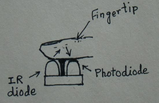

i find the problem...resistors of photodiod and Q1 are the problems.Resistors of photodiod need be set correctly to receive better because this sensor is so sensitive to every noise like lcd ,battery,op-amp near sensor or like this.
resistor of IRdiod must be set 120-220 but about photodiod's resistor after Setting up IRdiod i use ohmmeter to know photodiod Resistance it was 80k so i used 33k ,a smaller amount than half to connected photodiod to vcc.photodiods Resistance are different u must setting up irdiod first then measurement the Resistance...heart rate is like this picture so resistors of Q1 must set correcly why ? because the problem is Q1 gonna show pulse for every peak so we see so many heart rate in lcd like mine about 330 pulse so we need to set resistors correcly to get pulse just for highest peak in each periodicity but if we dont want details of heart rate we can use op-amp like picture to filter low peaks....maybe this will help someone and sry for my bad drawing :D
