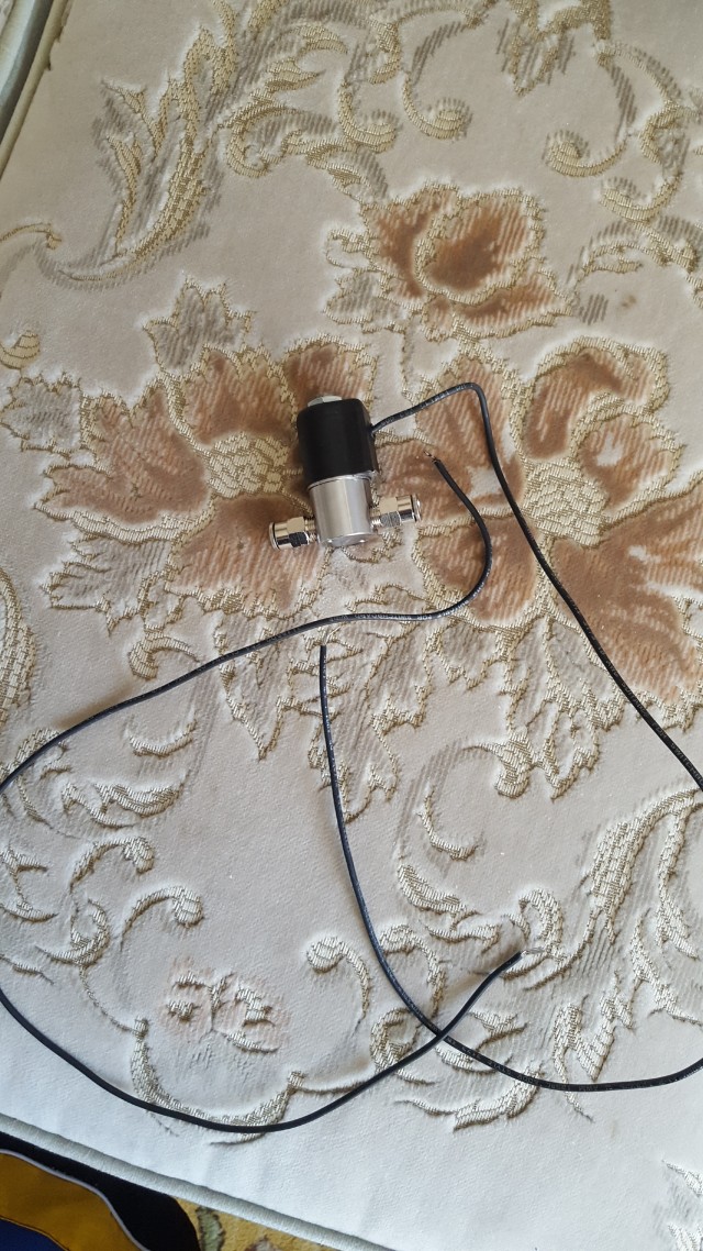

I recently purchased a solenoid for my car which controls the flow of methanol. After seconds of use it melted. It got so hot that I burned my hand when trying to move it and the solder inside melted with a wire falling off.
I contacted the seller and they told me I had used the solenoid with a controller that was incompatible.
The thing is this is a 12 volt solenoid, rated at 4.75 amps. My original solenoid was only 12v and 1.5 amps.
I do not understand how the solenoid could melt, unless it was defective?
Surely I could connect the solenoid directly to the 12v car battery for 3 seconds and then disconnect it and it would be ok. Wouldn't it only draw the 4.75 amps? That is not what I did, but I don't believe it should melt.
I look forward to hearing peoples thoughts. So we are talking 12 volts DC.

In automotive use it might see 14 V instead of 12, for a power dissipation of almost 78 W, which is a lot unless there is significant "thermal mass" to the coil. Still, 3 seconds is a small fraction of the nominal allowable ON time.
Can you post a photo or a link so we can get an idea of the physical structure?

ebp
Joined Feb 8, 2018
2,332
Without anything for scale, it is a bit hard to tell what the size is, but going by the wires, I'm guessing the ports are 1/8" NPT and the body is about an inch/2.5 cm in diameter.
It is probably rated for 12 volts "actual", so automotive "12 volts" might be pushing to the maximum permissible voltage. Even at exactly 12 volts, 4.75 A, 57 W is an awful lot of power for a coil that size. 5 W continuously would make it quite warm. But once again, even with 14 V, I have my doubts about a 3 second activation being enough to kill it. Is there any chance that the controller that had been used at 1.5 A failed short-circuit and kept it powered for too long? A transistor might fail quite quickly at three times the expected current, and failure mode in transistors is usually short-circuit, at least initially.
That design won't get very much cooling from flow. The end of the coil adjacent to the valve body would get a little cooling, but the other end of the coil would get next to none. In the valves like that that I have seen, the coil is on a bobbin that just slides rather loosely in place and, with the cover, is held there with the nut at then end of the actuator tube.
Is it rated for some very high pressure? That is a remarkably powerful coil for a small valve.
I've seen polarized solenoid valves designed to mount on a manifold plate. There are "latching" types that are polarity-dependent. I've never seen a conventional type in that style that was polarized, but I've only ever seen a couple dozen types up close. A polarized type would not have both leads the same color.

Swaswa
Joined Dec 20, 2016
14
The solenoid is rated for up to 300 psi. The base of the solenoid is a solid block of aluminium and water and methanol will be flowing through it at about 0.7 litres per minute.
I do wonder if there was a short circuit
