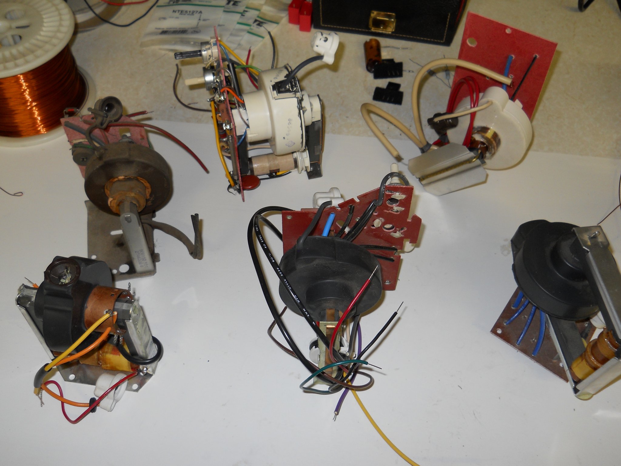

LOPT Selection:
The most desirable transformers are those intended for direct production of full (AC) EHT potential for application to external 'non-multiplicative' rectification pursuant to development of accelerating potentials for large CRTs -- Contrary to 'conventional wisdom' such units are yet readily available from long-established electronics supply houses (whom, in my experience, are only too happy to wave 'minimum purchase' and 'wholesale only' policies at the prospect of disposal of what they regard as 'dead stock') --- That said, one should expect to size their purchase so as to offset the supplier's 'invoicing costs'... Prices ranging from $20 (USD) per transformer (in reasonable quantities) are not uncommon...

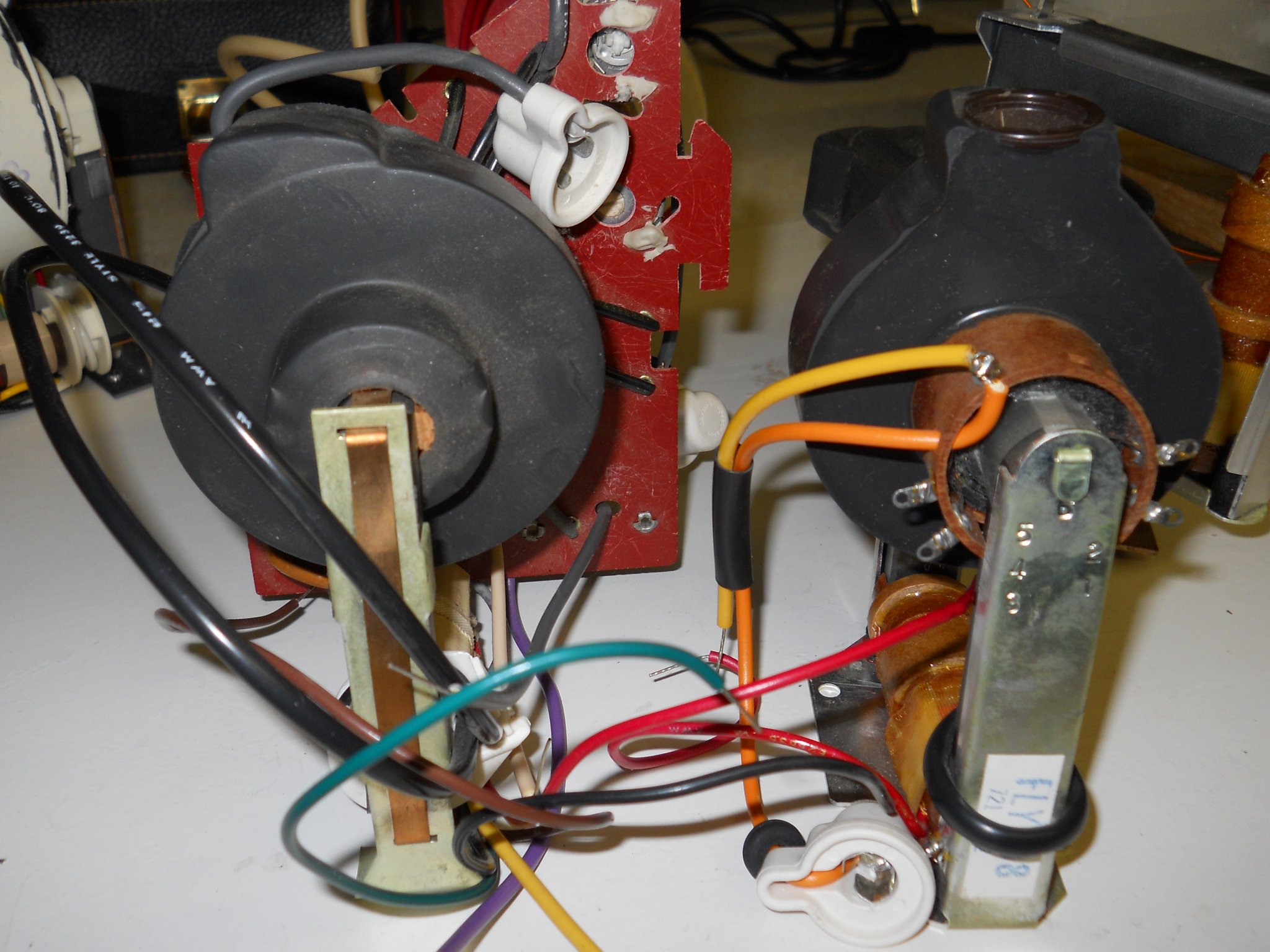

The following images are offered as an aid to recognition of the desired form factor:
Assorted LOPTs typical of the desired geometry:
vvvvvvvvvvvvvvvvvvvvvvvvvvvvvvvvvvvvvvvvvvvvvvvvvvvv
Detail - Axial view:
vvvvvvvvvvvvvvvvvvvvvvvvvvvvvvvvvvvvvvvvvvvvvvvvvvvvv
Detail - Transverse view:
vvvvvvvvvvvvvvvvvvvvvvvvvvvvvvvvvvvvvvvvvvvvvvvvvvvvvvvvvvvvv

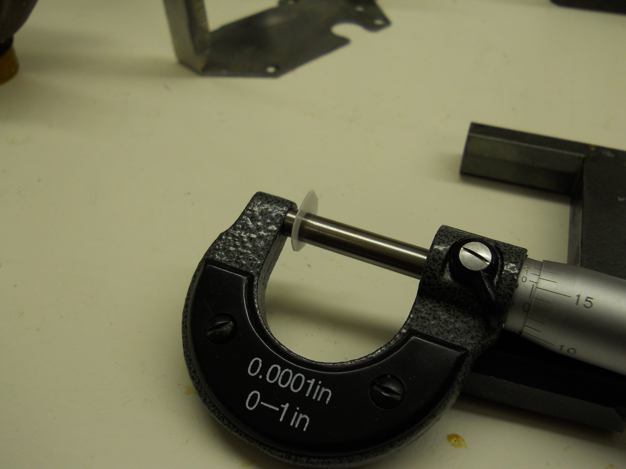

⇒Micrometer (Vernier)
Range = 0-25mm / Res=1um {metric} -OR- Range = 0-1" / Res= 1/10,000" {imperial}

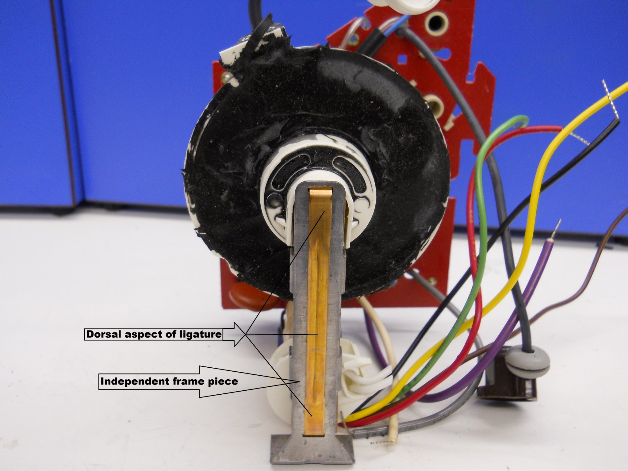

Style 2) Features two independent metallic frame pieces OR a metallic half-frame and a backing plate/board -- such assemblies are bound by a single "U- bolt"/"U-strap" or two linear bolts/straps extending along the outer aspects of each horizontal form leg...
Examples of style 2
View of LOPT from 'closed' side of "U-bolt" ligature
View of LOPT from 'open' side of "U-bolt" Ligature
View of LOPT from 'closed' side of "U-strap" Ligature
View of LOPT from 'open' side of "U-strap" Ligature

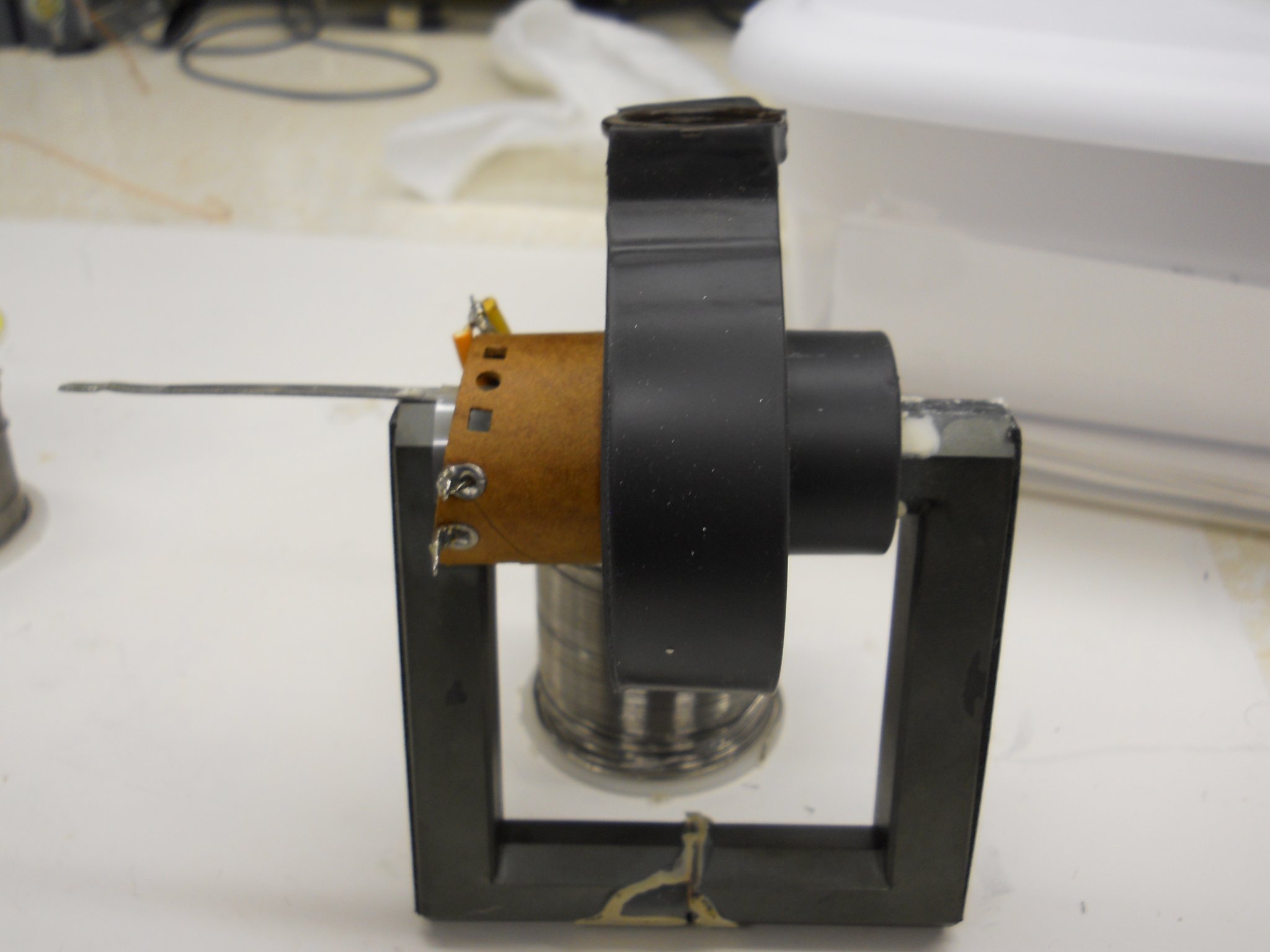

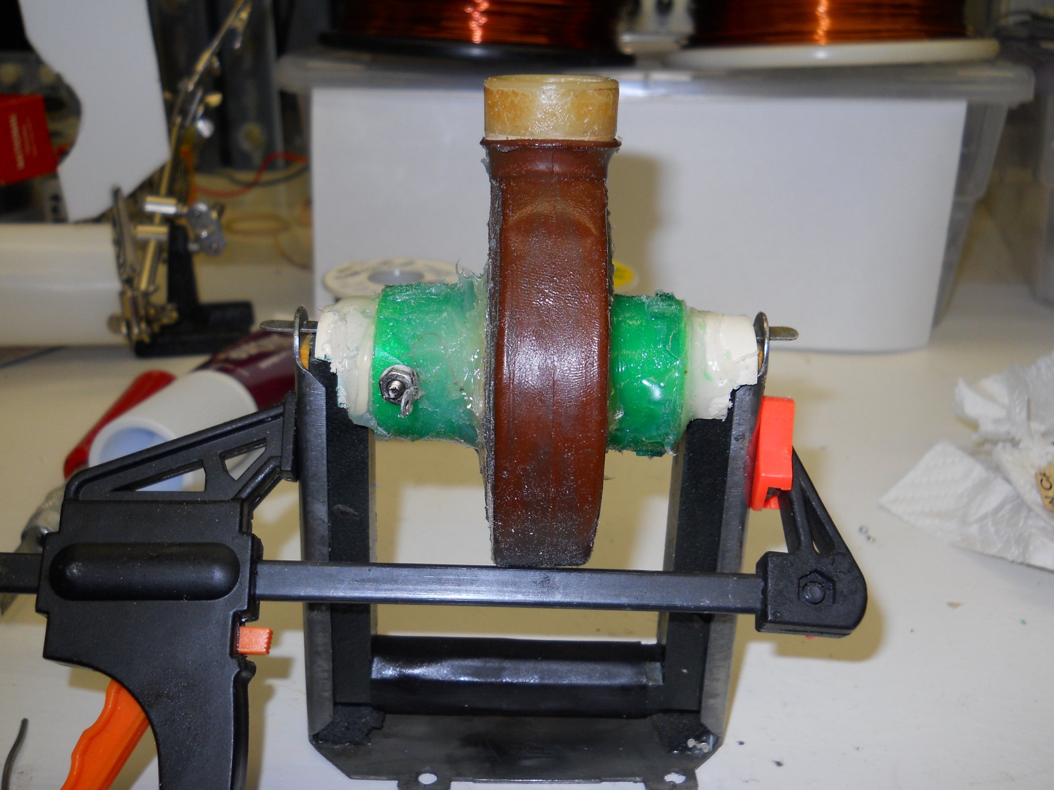

Image of transformer following removal from a single strap-ligature frame:

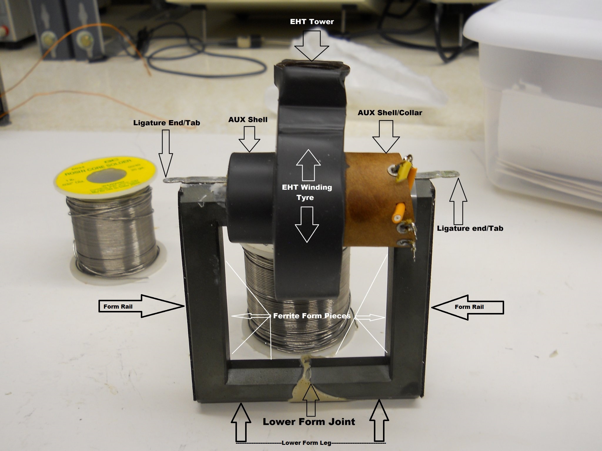

Annotated image of assembly features referenced in following steps:

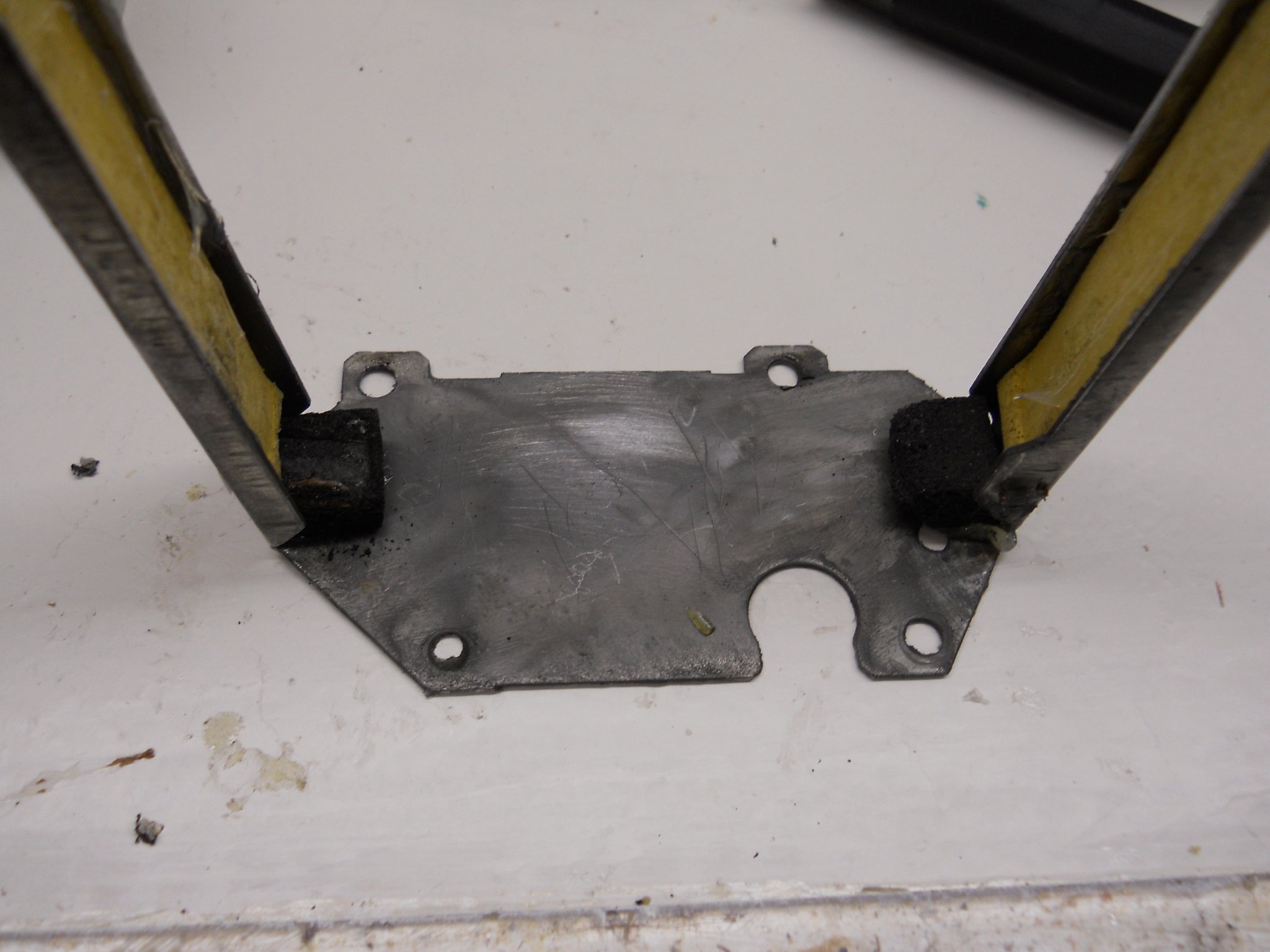

Step 1-3) Procedure for removal of strap ligature{s} from LOPT core/winding assembly:
Tasks
1)
Meticulously straighten and deburr exposed segments of the frame ligature{s}.
2)

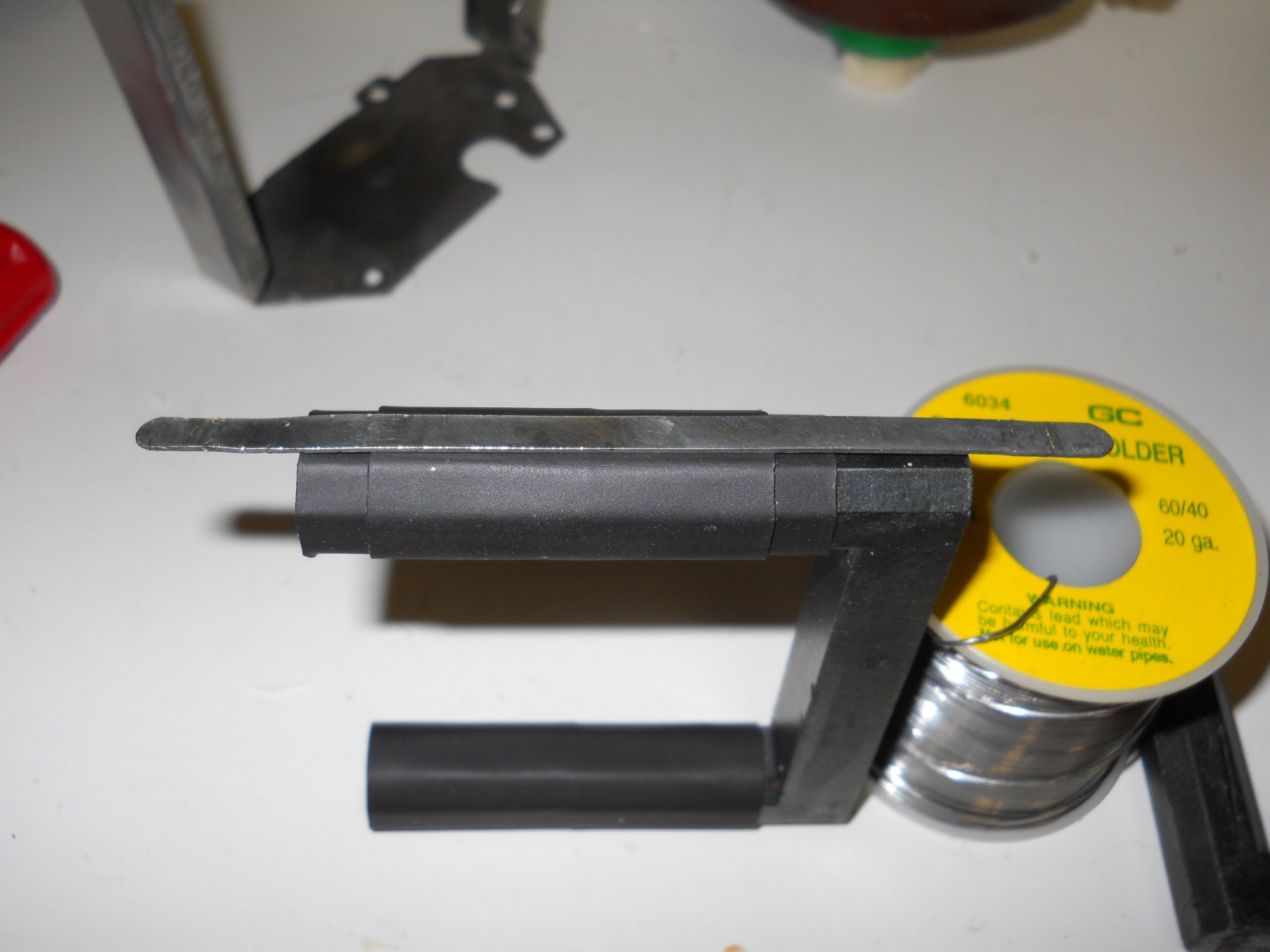

Carefully 'work' the frame ligature{s} free of the adhesive, then withdraw it/them from the space intervening the form and winding (and, hence, from the assembly) -- Under no circumstances apply counter-thrust or torque to the EHT winding!
Ligature partially withdrawn from assembly.
Ligature (in foreground) fully withdrawn from assembly.
vvvvvvvvvvvvvvvvvvvvvvvvvvvvvvvvvvvvvvvvvvvvvvvvvvvvvvvvvvvvvv
Note: Inasmuch as same will be removed and discarded in later steps, damage to the external auxiliary windings (i.e. those on the form leg opposite the EHT winding) or coaxial auxiliary windings immediately adjacent to the core/form leg is of no consequence -- Care must be exercised, however, to avoid damage to the brittle ferrite form/core via excessive force or mechanical shock... Also - avoid handling the assembly by the EHT winding!

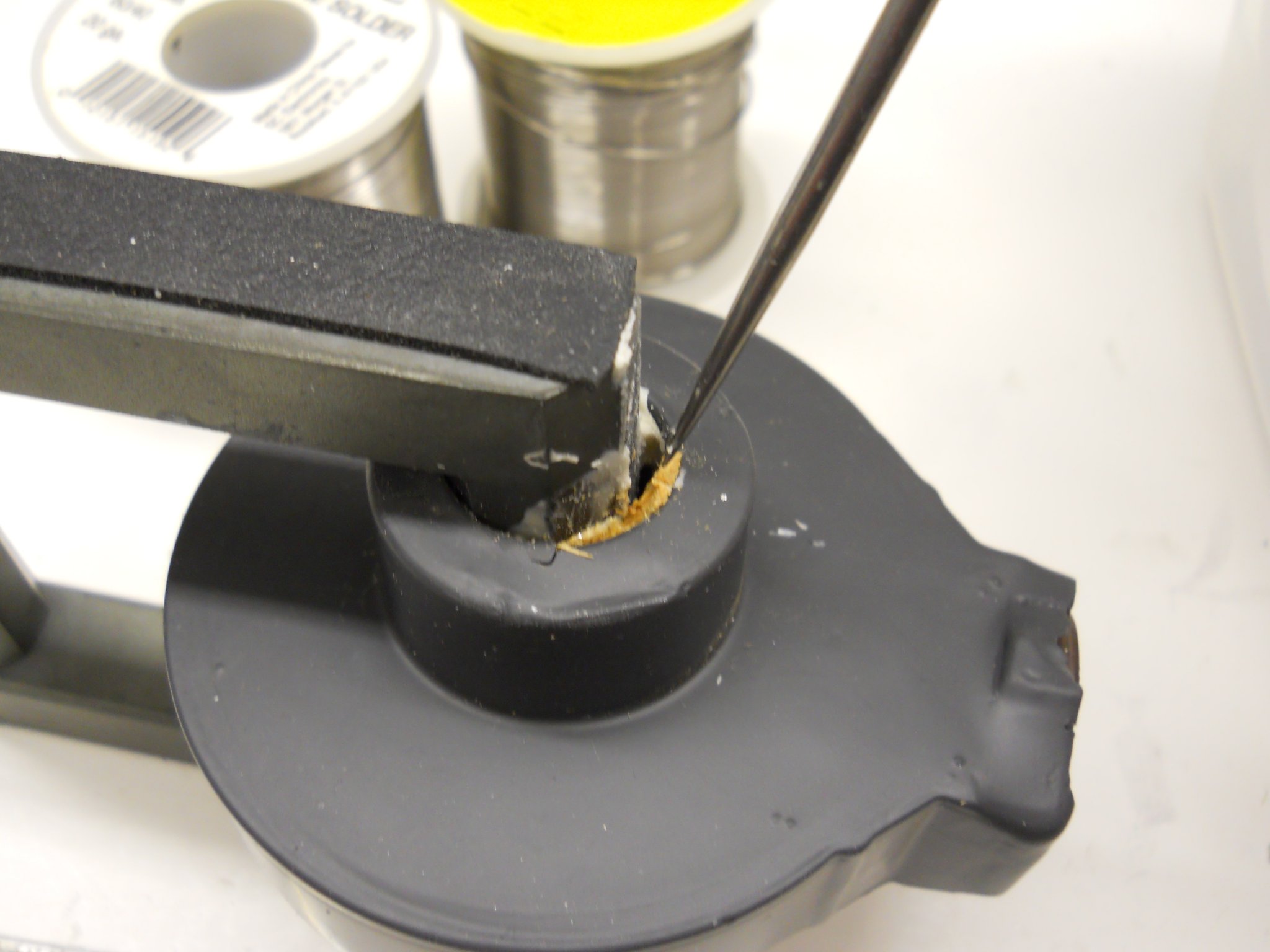

Step 1-4) Removal of external auxiliary windings from 'lower leg':
Tasks:
1)
Using an appropriate scalpel, 'X-Acto knife' or similar implement, linearly section the full length of the external Aux winding assembly. --- Again, the referenced winding resides on the form leg opposite that carrying the EHT winding!!!
2)
Peel, crumble and/or break the 'external' Aux winding assembly off of the lower form leg.

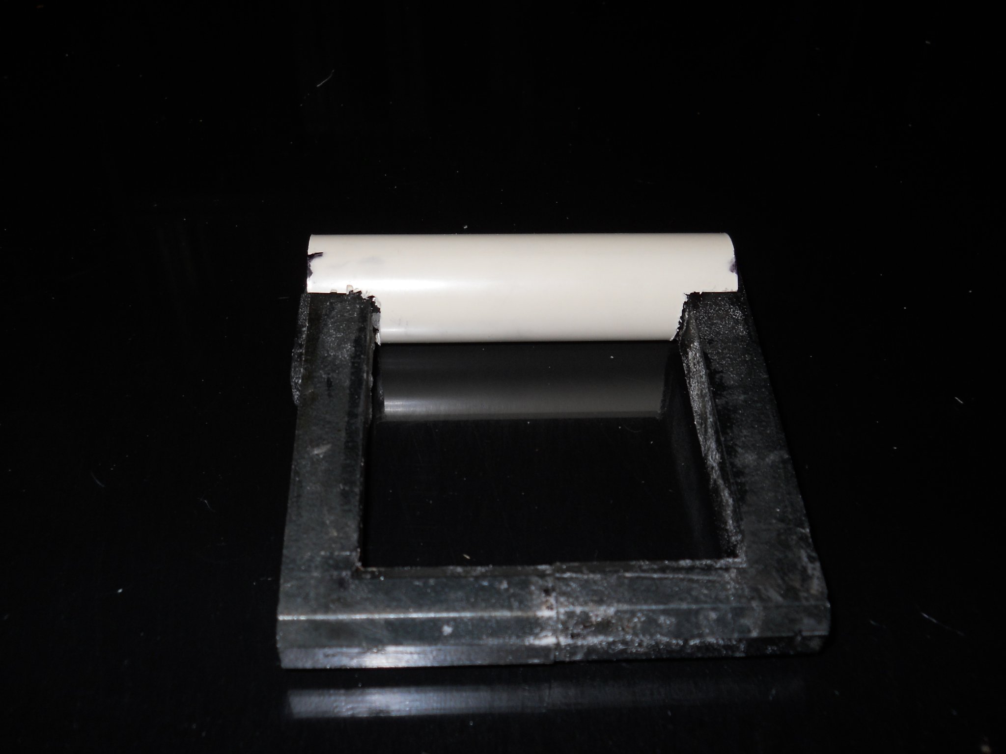

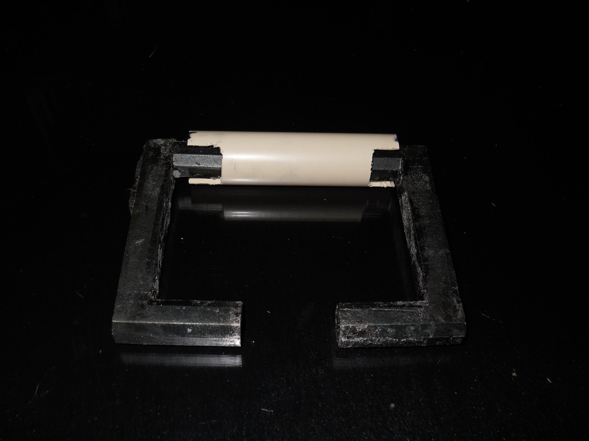

Step 1-5) Separation of form pieces
Caution: In performance of the following tasks, it is of paramount importance that neither torques nor linear forces are applied to the EHT tyre! -- Moderate forces may be applied to the auxiliary shell and moderate compressive force may be applied to the ferrite form longitudinal to the EHT winding 'leg' only!
Tasks:
Please note that task #1 is with reference structures coaxial to the EHT winding
1) Endeavor to remove (or loosen) any shims intervening the form and inside surface of the auxiliary sleeve -- While damage to the auxiliary sleeve or winding is of no consequence, care must, nonetheless, be exercised to avoid breakage of the form!
Image of wooden shims (indicated by pick)
2)
Using a #3 sharp fenestrated uterine curette, or similar non-ferromagnetic stainless steel instrument, carefully 'clean' the lower form leg of superfluous epoxy -- Note: Use of razor blades or other ferromagnetic or 'soft' metallic instruments will likely 'foul' the ferrite via metallic transfer to same!
3)
Submerge the lower leg of the form (prepared as per task #2 above) in acetone for a period of ≈ 90 minutes at 7°C (45°F) through 33°C (90°F) - Note: the EHT winding assembly must not be submerged, splashed or otherwise wetted with acetone! - nor should acetone be allowed to condense on same! Owing to the flammability of ketones, said procedure is best preformed in open air or in an open container 'under' an OSHA (or jurisdiction-equivalent authority) certified fume hood (caution! - this does not include 'range-hoods', 'range fireplaces', 'walk-in fireplaces' or their ilk!) -- Moreover, a closed container is not recommended owing to liability to condensation...
4)
Upon removal of the lower form leg from the acetone bath, drive the reluctance spacer out of the lower form joint using an appropriate feeler gauge leaf --- Note that during and following removal of the reluctance spacer/adhesive from the lower form joint, application of even moderate constrictive or distensive forces to the form will result in significant cantilevered forces at the upper form joint with (almost certain) breakage of one or both form pieces.
Of special concern in this regard:
A) Do not attempt to expand the gap while removing the spacer! -- The leaf thickness must be less than the gap width. Maintenance of a parallel relationship between leaf and form piece ends (i.e. gap 'walls') is imperative!
B)
Following removal of the spacer, take care to avoid application of constrictive/distensive forces or piece-to-piece torsion to the form! -- The safest handling method is manipulation of the assembly from one 'side' (i.e. by one form piece) only!
Note: Following clearance of the lower form joint of its reluctance spacer and adhesive, continued half-to-half form tenure owes to the upper form joint adhesive (at the center of the EHT winding assembly) - and, to lesser extent, adhesion of each form piece to the form sleeve of said assembly.
5)
Using a 'heat gun', play a stream of hot (≈200°C /400°F) air in a swiftly alternating, sweeping pattern upon each 'form rail' taking great care to avoid directing said stream upon the EHT winding tyre! - In this fashion gradually and evenly increase the temperature of each 'rail' to ≈ 100°C / 200°F.
6) Wearing "welder's gloves" grasp form rails (each to a hand) then apply torque (not to exceed 5.5 N⋅cm!) axial to the upper form leg.
A) If/when form-rail to form-rail angular motion is evident, continue rotation until the pieces rotate freely relative to each other -- If necessary, the form sleeve may be used as a 'counter torque' but under no circumstances apply force of any kind to the EHT tyre!
B) In the event that relative angular motion/displacement is not discernible following 30 seconds' application of torque, repeat Task #5 (above) but heat the rails to ≈ 150°C /260°F then promptly repeat task #6 (above).
c) In the event that, having begun to move, sustained rotation becomes impossible prior to 'defeat' of the adhesive, repeat steps 5 and 6 (above) exactly as presented.
7) Carefully 'work' each form piece free of the form sleeve -- Again, avoid application of thrust or torque to the EHT winding tyre!
8) Thoroughly clean the form pieces of adhesive residue via 30 minute's immersion in acetone followed by scrubbing with an acetone wetted cotton cloth.

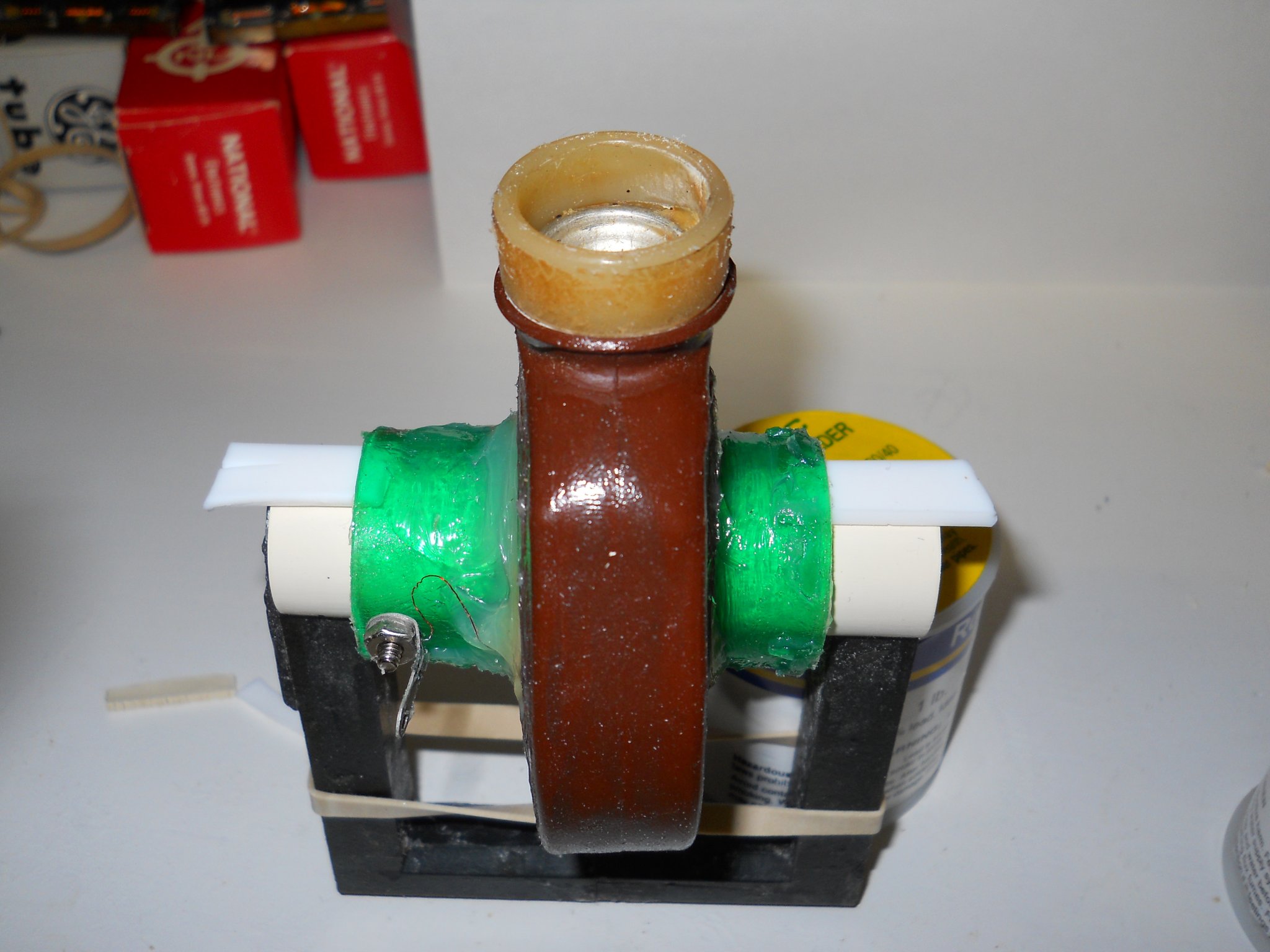

Image of unmodified EHT winding assembly.

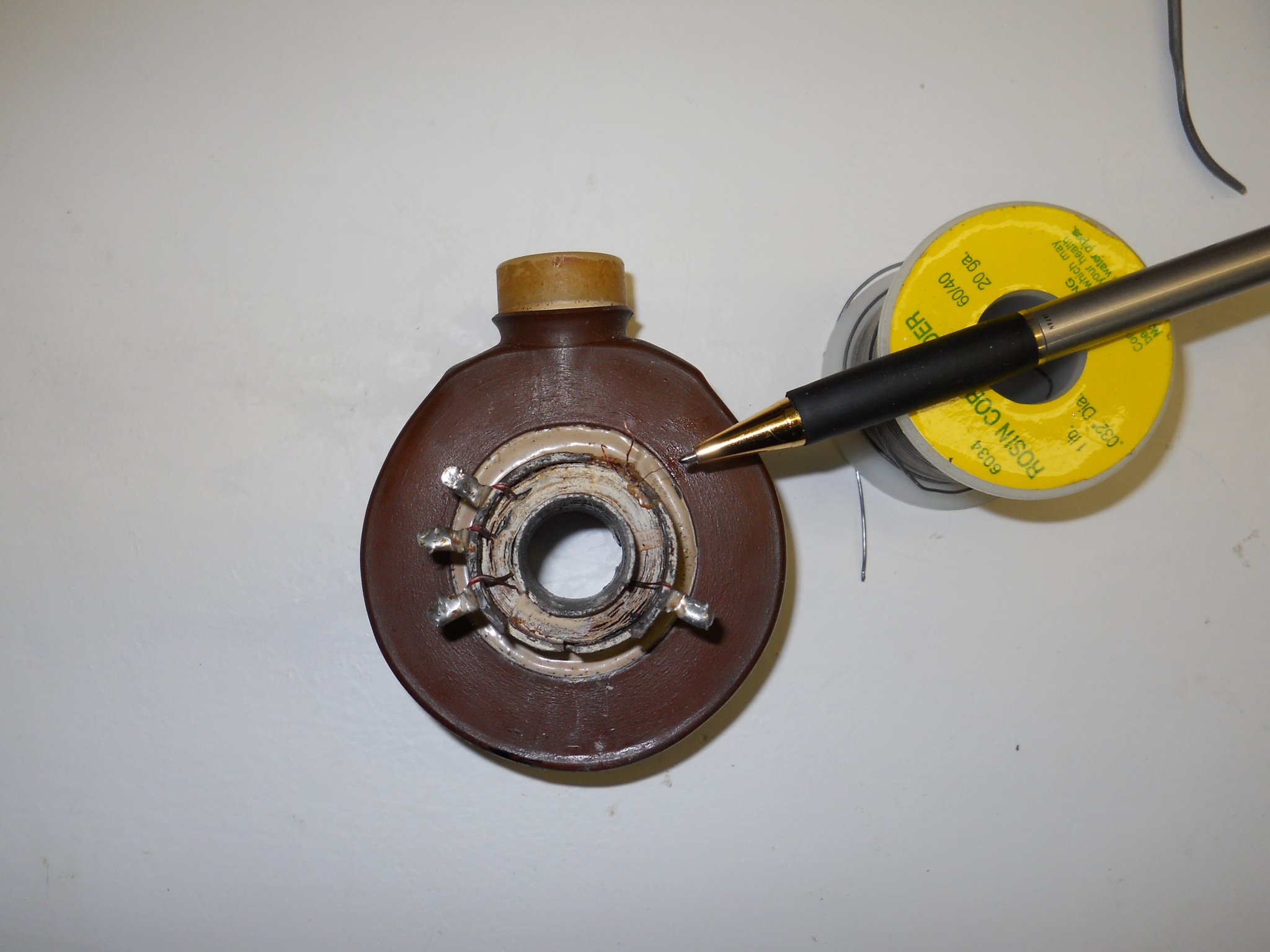

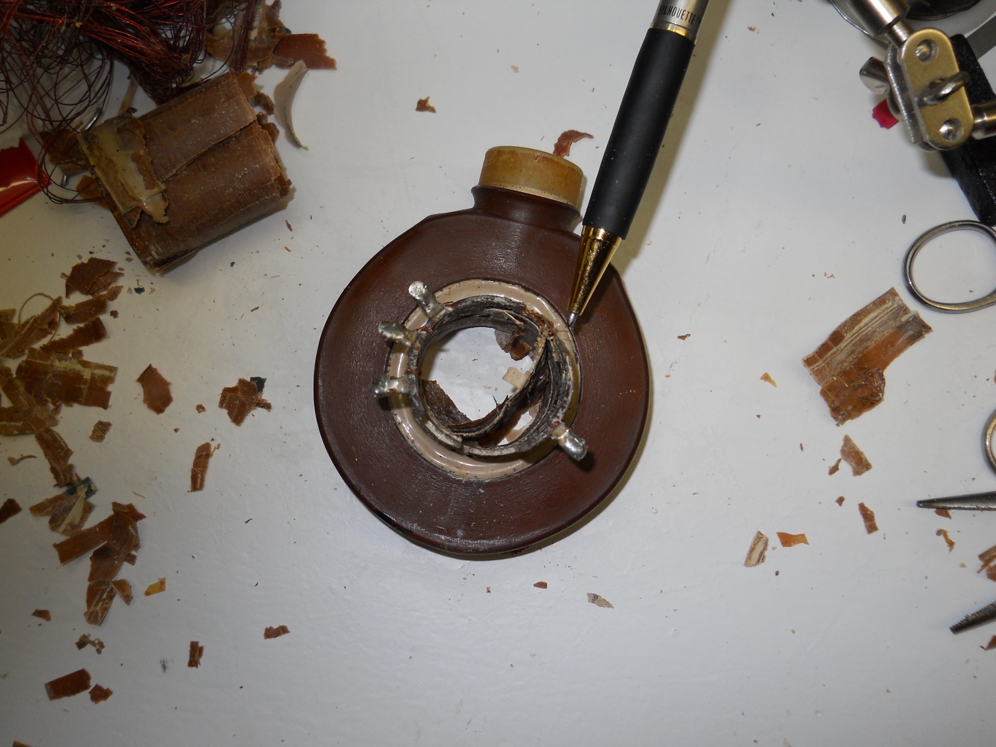

Step 2-1) Locate the lug carrying the EHT return:
The EHT return generally emerges with one or more AUX leads from the peripheral circumference of the AUX winding whence they are tied to a shell lug...
In the case of the demonstration transformer, said lug occupies the 2-o'clock postilion -- The image below shows said leads emerging from the Aux winding immediately below the CCW edge of the lug (as indicated by the ball-point pen) -- of special significance is the extreme peripheral position of the break-out point.

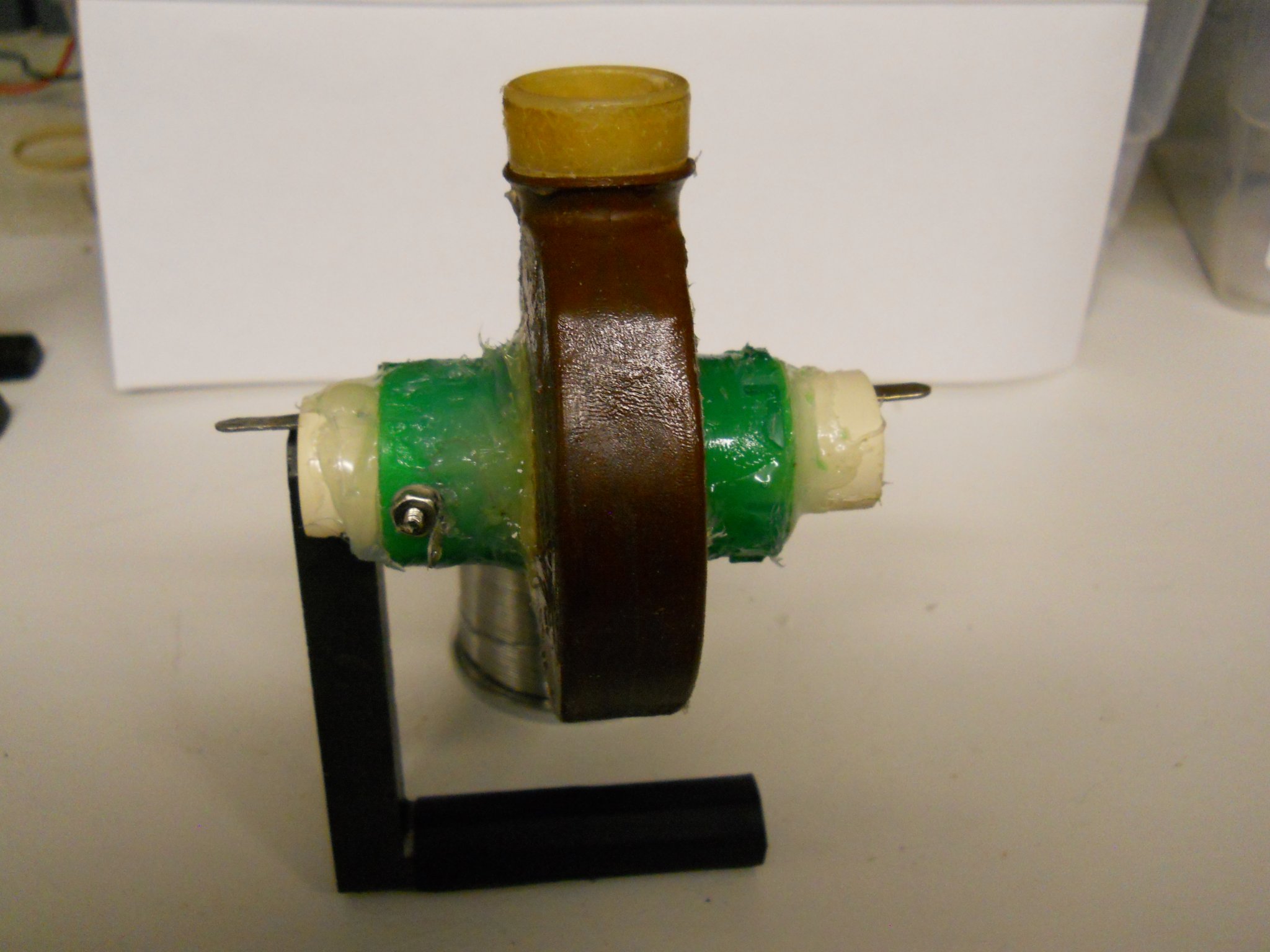

Image of the bundle containing the EHT return.
Step 2-2)
Separate and identify the EHT return:
Tasks:
1)
Carefully unsolder all leads from the lug identified in Step 1 (above).
2) 'Untwist' and otherwise separate said leads.
3) Using a resistance indicator, check each lead for continuity to the EHT output contact (i.e. 'output tower') --- the return lead will show a resistance of between 400Ω and 1000Ω -- All other leads should show infinite resistance.
In this case three leads were tied to the lug -- the resistance examination identified the 38 AWG lead as the EHT return (said lead indicated by the pen in the attached image).
Image of separated EHT return --- Note that the associated lug was broken out of the way.

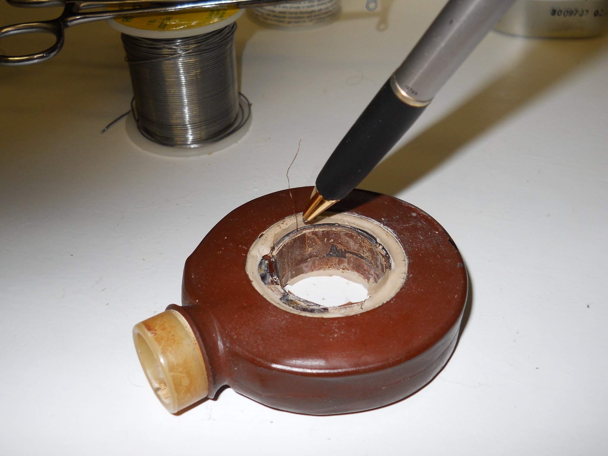

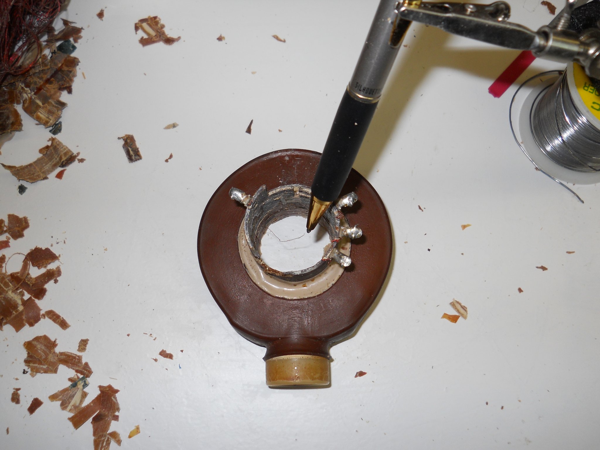

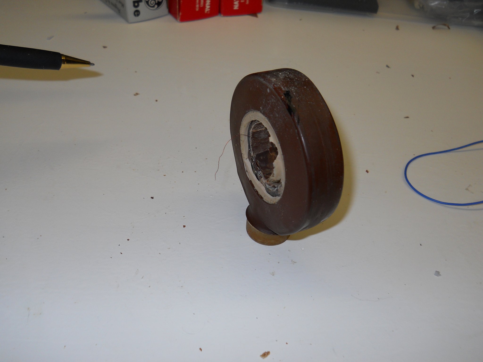

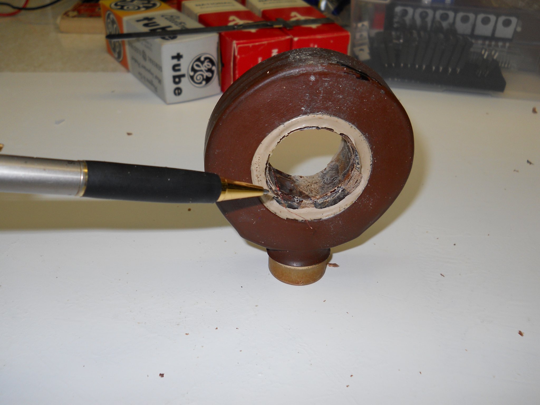

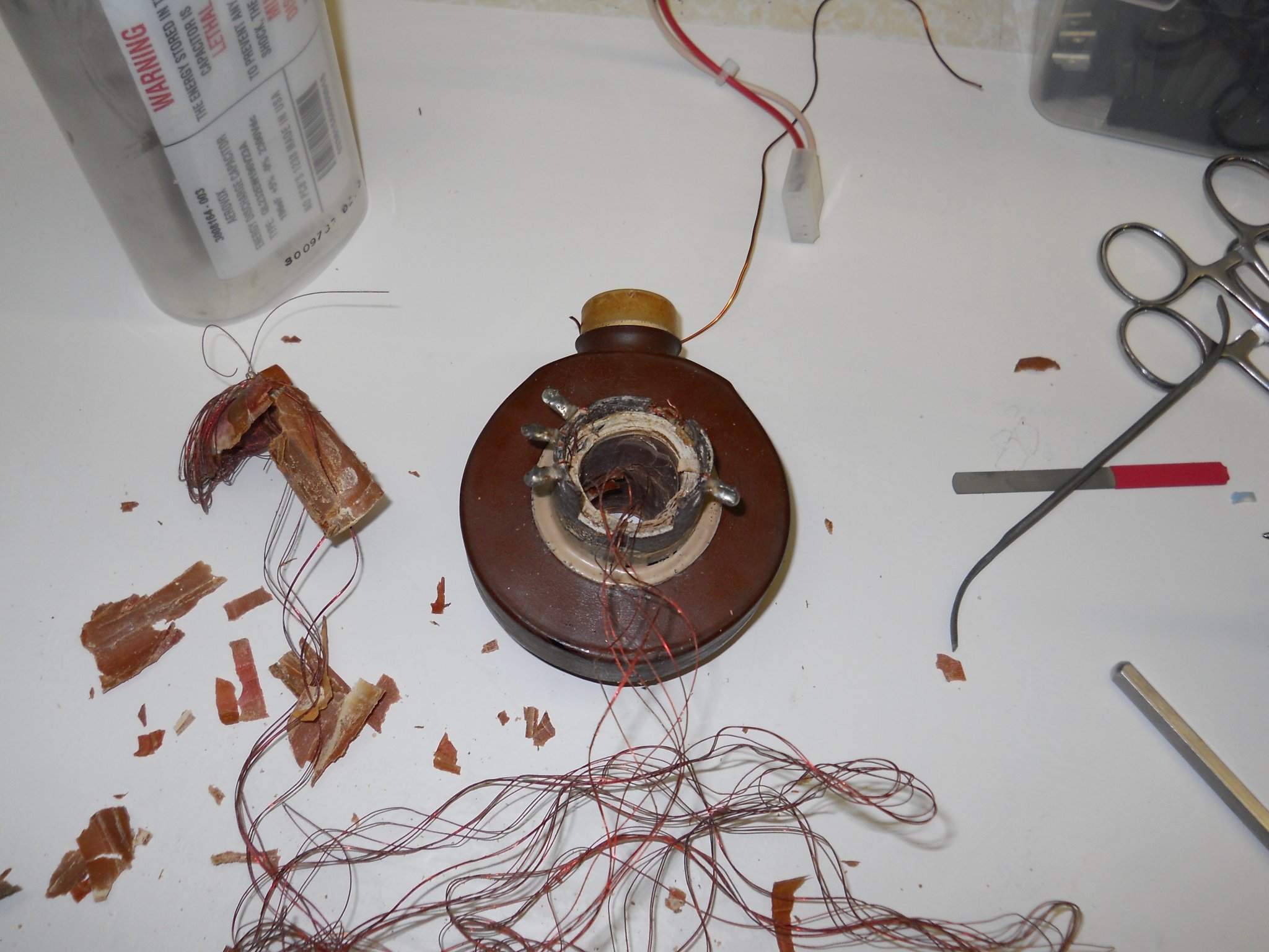

Step 2-3
) Removal of the form sleeve:
Please note:
Far and away the most significant challenges attending this procedure owe to the 'gossamer' nature of #38 and #40 AWG conductors... From this point onward it will behoove the reader to remain mindful of the EHT return whenever handling the assembly - while a severed or broken return lead is not necessarily 'fatal to the cause' - such will greatly complicate matters via the requirement of 'teaseling out' the end of a #40 or even #42 (AWG) lead from the lacquered winding!
Tasks:
1)
Carefully dress the return lead out of 'harm's way'.
2) Twist, pry and/or break the form sleeve out from the center of the Aux winding.
Image of EHT winding following removal of the form sleeve. Note the EHT return at ~ "2 O'clock"

Step 2-4) Remove the AUX winding:
Precautions:
A)
While 'unraveling' the Aux winding, apply counter-thrust only to the shell --
as opposed to the tyre!
B)
While debriding residue from the 'central gap' following removal of the Aux Shell - great care must be exercised is damage to the central layer{s} of the EHT winding to be avoided!
Tasks:
1) Cut all leads attached to all remaining lugs.
2) Using a surgical pick or similar instrument, pry a few 'layers' of the Aux winding into the center such that they may be grasped with forceps.
Image of Aux winding prepared for removal.
3)
Grasp the the loosened layers and begin withdrawing ('unraveling') the Aux winding -- Taking great care to avoid application of tension to the return lead as the periphery is approached.
Image of Aux winding in an intermediate stage of removal.
Note: The EHT return will typically be 'laminated' between the penultimate and ultimate layers of the auxiliary winding bunting.
4)
Cautiously break (not tear!) the bunting material away from the return lead.
In the image below you may observe the end of the EHT return (as per the pen) and its emergence from the bunting in the gap intervening the shell and the deflected bunting medial to the remaining lug at 4 O'clock
Image of EHT return embedded in peripheral Aux winding bunting.
Image of EHT winding following complete removal of Aux winding
vvvvvvvvvvvvvvvvvvvvvvvvvvvvvvvvvvvvvvvvvvvvvvvvvvvvvvvvv[/B]
Step 2-5) Remove the AUX Shell:
Tasks:
1)
Carefully break, crumble and/or fold the auxiliary shell into the 'central gap' via symmetrical application of force to the distal aspects of the former at quadrature to the plane of the return's emergence.
Under no circumstances attempt to pry the shell from the interstices!!! Doing so will almost certainly damage the EHT winding beyond repair!
2)
having thus loosened the shell, carefully remove the fragments being ever mindful of the return...
Images of the EHT winding following removal of the auxiliary shell...
Image of EHT winding and debris following removal of the form sleeve, Aux winding, and Aux shell:

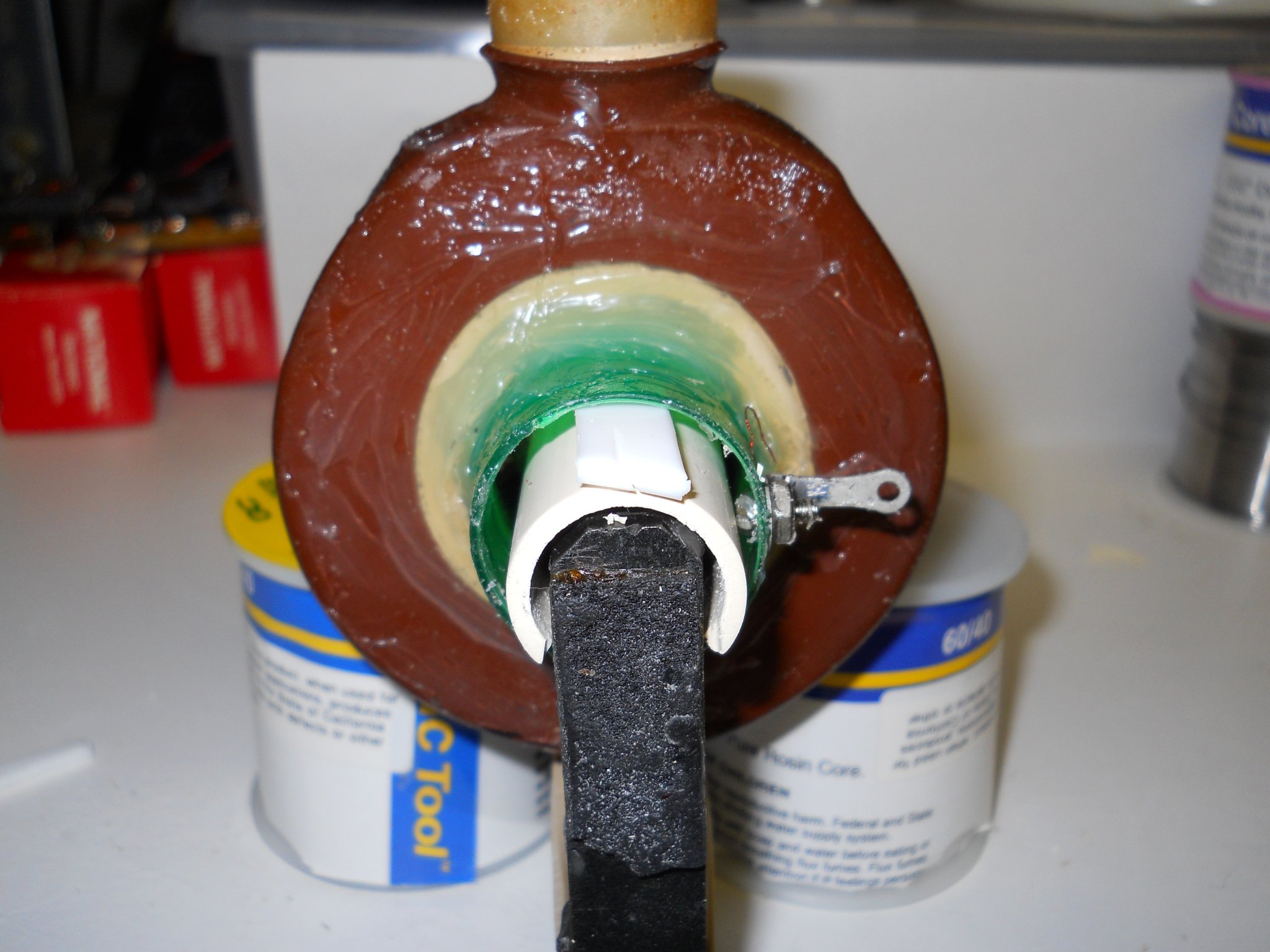

Step 2-9) Installation of the Lug and connection of the return:
Tasks:
1) Carefully insert the #4 bolt from inside the shell.
2) Secure the lug to the top of the shell as shown in the images below.
3) Solder-tin the end of the return lead.
4) Insert ~ 2 mm of the return lead into the #66 hole near the base of the lug then secure it with solder.
Note: It is imperative that the return lead is neither trimmed nor glued at this point! - Please loop any slack as shown in the images.
Images of the assembly; Dummy shell & Lug installed, return connected:
5)
Verify that the DC resistance (lug to output tower connector) -- is that measured in step #2-2, task#3

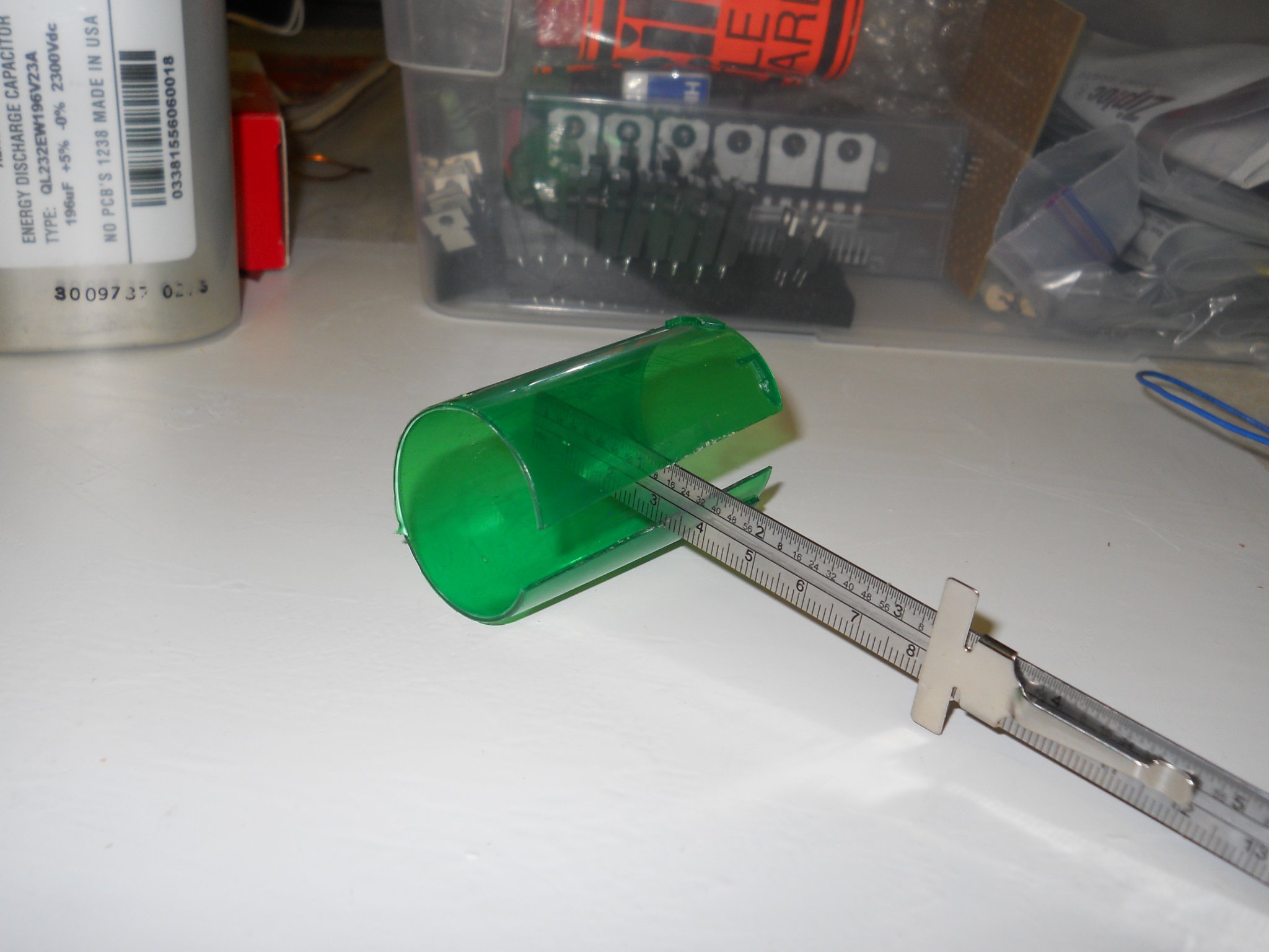

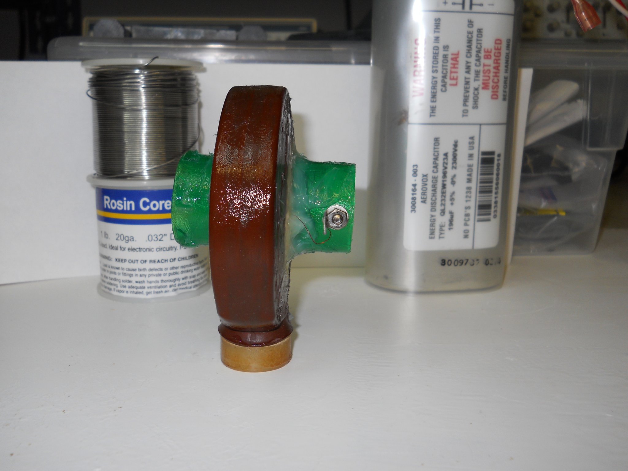

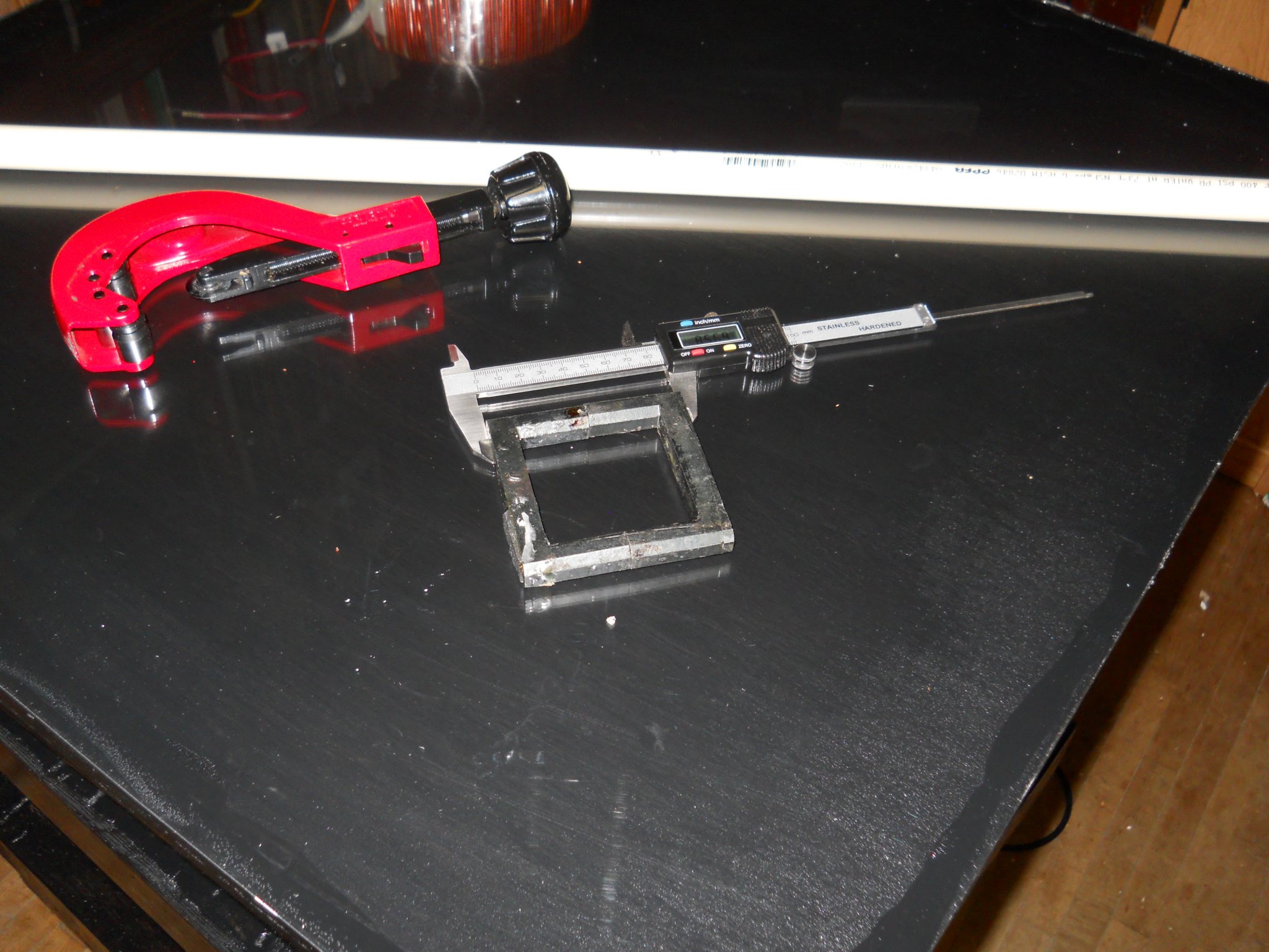

Step 2-10)
Prepare the CPVC Form sleeve:
Tasks:
1) Cut a length of 3/4" id (CTS) CPVC tubing equal to the total length of the form-leg on which it will be placed (In the case of this demonstration 8.5 cm) See the two images immediately below...
Image illustrating desired sleeve dimension
Image of form and adjacent CPVC section cut as per task #1
2)
Cut 'shoulder stirrups' into the CPVC Sleeve:
Note: the stirrups must be sufficiently deep as to allow a slight amount of end-clearance when mounted upon the form (such that form piece apposition is assured).
Image of form pieces and 'prepared' CPVC sleeve
Image of form and CPVC sleeve in an intermediate state of assembly
Image of (temporary) fully assembled form and CPVC assembly

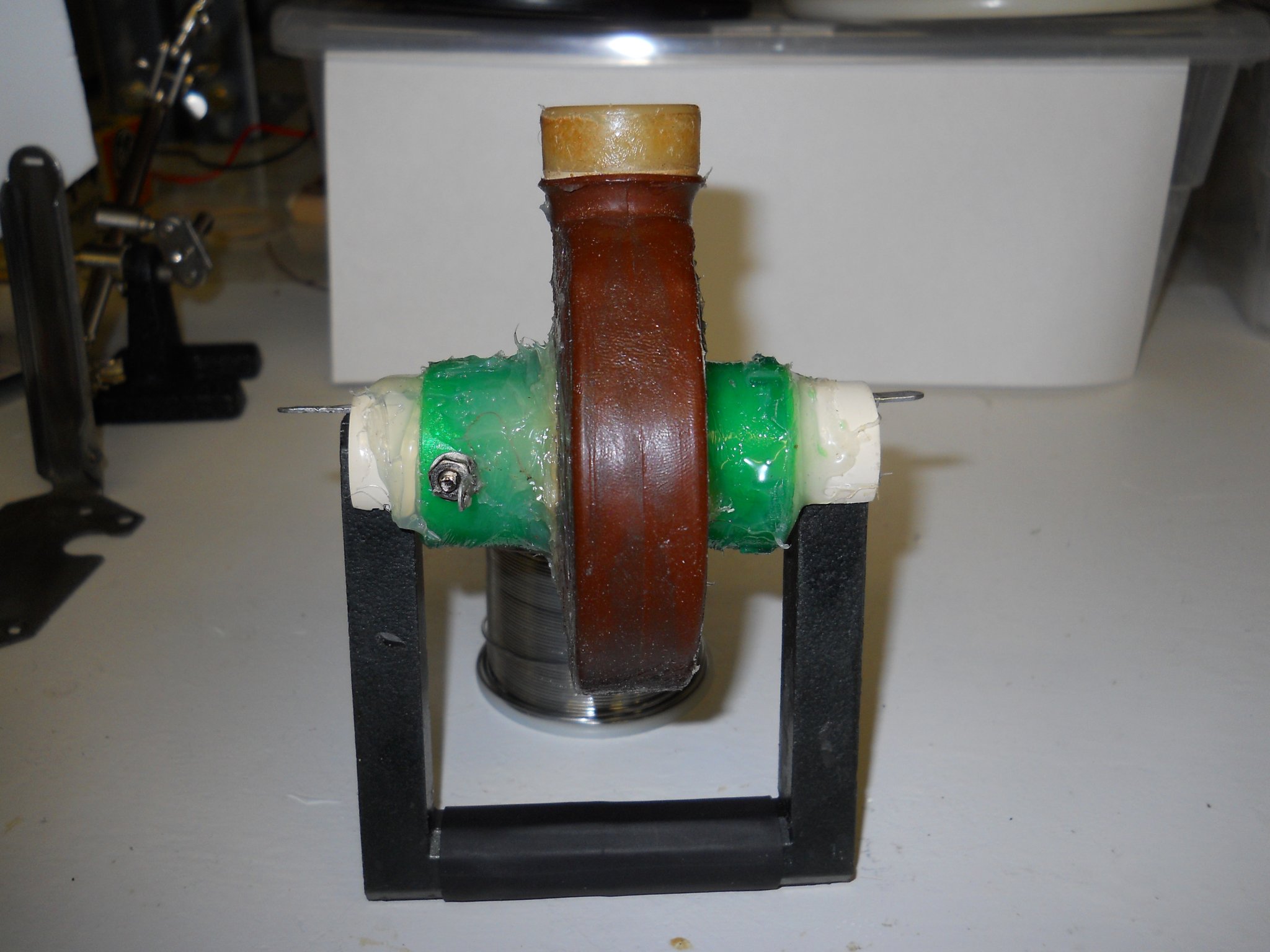

Step 2-11)
Permanently install CPVC form sleeve in EHT winding assembly:
Image of components referenced in this step:
(L to R) CPVC sleeve, EHT winding assembly, Form [core] pieces
Tasks:

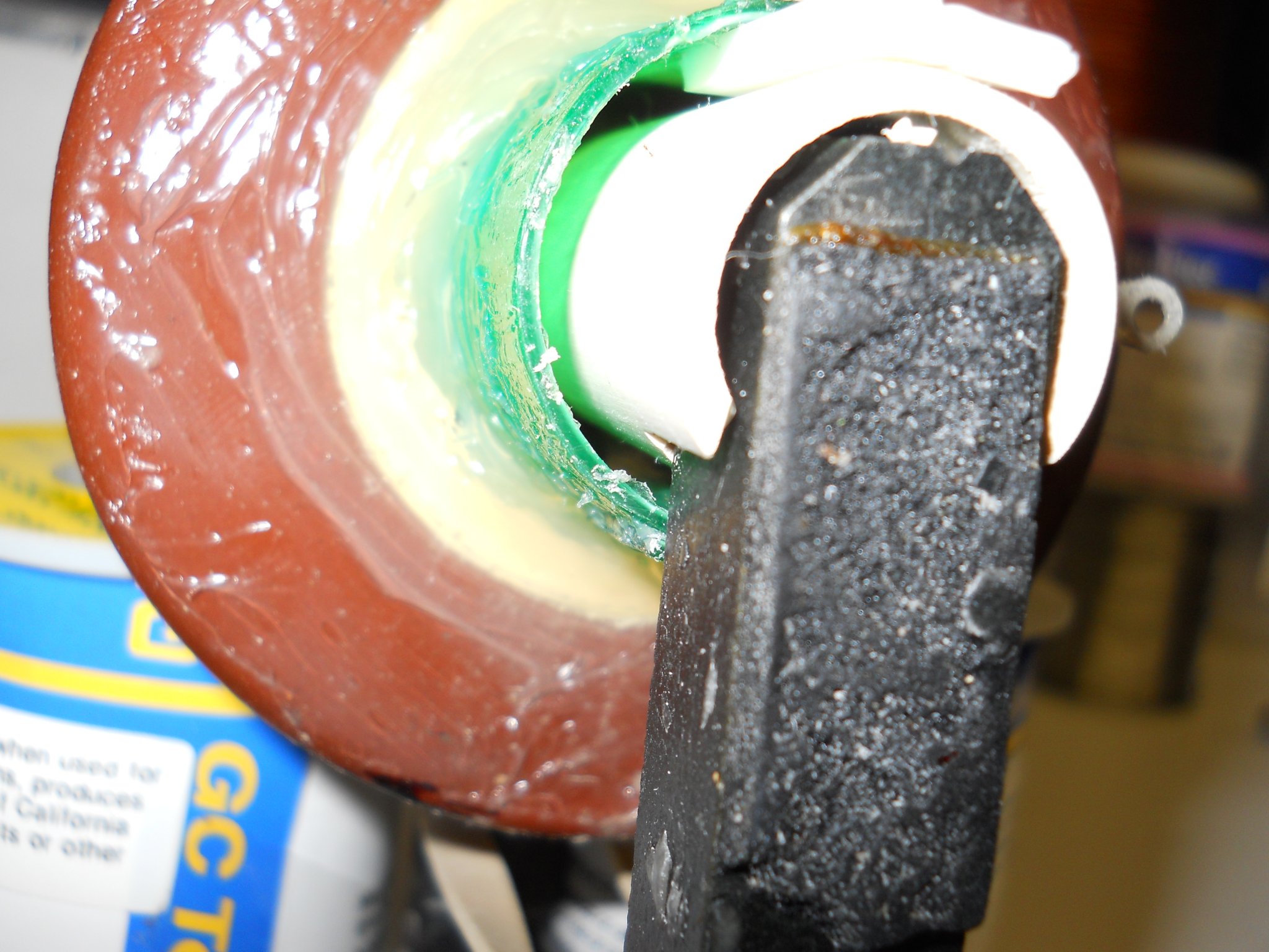

1)
Assemble EHT winding, CPVC sleeve and form as shown (below).
2) Using PTFE shims, center EHT winding assembly about CPVC sleeve (both sides).
Note: While the adhesive does not bond PTFE it is, nonetheless, essential that the shims be so formed as to preclude (interlocked) captivity in the former!
Images of mounted and centered EHT winding as seen from 'EHT return side':
4)
Using acrylic-based 'hot-melt' adhesive, tack the CPVC sleeve to the polypropylene shell at several points each side.
5) Remove form pieces.
6) Fill the space intervening the CPVC sleeve and the PP shell with acrylic-based 'hot-melt' adhesive taking care not to disturb the relative positions of said structures!
7) Allow the adhesive at least 60 Minutes to cool/cure.
8) Withdraw the shims.
Image of assembly immediately following withdrawal of shims as seen from EHT return side.
9)
Fill the 'shim gaps' with acrylic-based 'hot-melt' adhesive.
Image of EHT winding assembly following completed installation of CPVC sleeve.

Step 2-12) Prepare form guides
Prior to proceeding, it is imperative that the form pieces are absolutely free of adhesive residue, etc!
Tasks:
1)
Trim two pieces of polyolefin tubing such that they extend the full inside length of each 'winding leg' of the assembled frame (as shown below).
2) With the sleeves in place on the form, clamp or otherwise place form pieces in firm apposition with close attention to alignment of same.
3) Heat-process the polyolefin tubing -- Note: expeditious completion of this step will significantly reduce liability to ferrite breakage (secondary to uneven application of heat) and/or permanent shift of magnetic properties (secondary to excessive temperature)...
4) Allow at least 20 Minute 'cool down' period then carefully disassemble the form such that the heat-processed polyolefin tubes remain installed on each 'half-leg' of a single piece.
5) Trim another sleeve then repeat the above procedure such that one leg is bound by a double layer of polyolefin.
Image of assembled form 'sporting' the unprocessed polyolefin sleeves (Post task #1)
###Improve descriptions below to indicate images follow separation of form pieces####
Image of form piece following processing of sleeves (Post task #4)
Image of form piece following processing of second sleeve (on arbitrarily chosen) EHT winding 'leg' (Post task #5)
Step 2-13) Fashion and place reluctance gap spacers
Note: Reluctance gaps will be incorporated to reduce liability to saturation (in all cases) and to leave the transformer compatible with 'flyback' topology should same be desired --- That said, this series prefers forward transfer paradigms (as explained in the introduction to this tutorial).
Note: The (.95mm) reluctance gap spacers salvaged from the disassembly process are shown in the "component identification image" for completeness of presentation only --- Based upon core material properties and desired output current, optimal operation requires development of reluctance gaps consistent with the inequality: 0.25mm < Gap < .5mm -- To this end 0.4mm (0.015" nominal) PTFE sheet stock will be used.
Tasks:
1)
Cut two small disks of PTFE having maximum major axes slightly less than that of the form piece 'ends'...
2) Check actual spacer thickness with a mechanical vernier micrometer (Resolution = 1 um -OR- 1/10,000 inch) note that a 'metric' instrument offers slightly finer resolution (inasmuch as 0.0001"=2.54 um)
3) Very lightly smear one side of each spacer with electronics grade RTV.
4) Place each spacer (RTV side down) flat upon each form piece end (inside each polyolefin sleeve).
5) Via firm tamping with a pencil eraser or similar implement assure that the RTV film 'tacks' the spacers to the form piece ends...
Image showing representative spacer and measurement of thickness:

Step 2-14) Assemble LOPT
Tasks:
1) Tack elastic cushions and form standoffs to frame then position as shown:
2)
Verify that the reluctance gap spacers are fast to the form piece.
3) Hold the frame ligature in lengthwise apposition with the utmost facet of the form's EHT winding leg. (i.e. the leg carrying a double thickness of polyolefin).
4) Carefully place the EHT winding assembly over the form piece leg and ligature such that the shoulder stirrup engages the form piece as shown below:
Form ligature in pre-assembly position:
Views of EHT winding, form piece and form ligature in intermediate state of assembly.
vvvvvvvvvvvvvvvvvvvvvvvvvvvvvvvvvvvvvvvvvvvvvvvvvvvvvvvvvvvvvvvvvvvv
5) Slowly press the opposite form piece into place allowing time for displacement of air from the polyolefin tubes.
6)
Install transformer assembly into frame such that the ligature strap ends extend through the 'ears' of the frame.
7)
Very carefully but firmly clamp the assembly preparatory to fastening...
8)
Solder ligature ends to frame

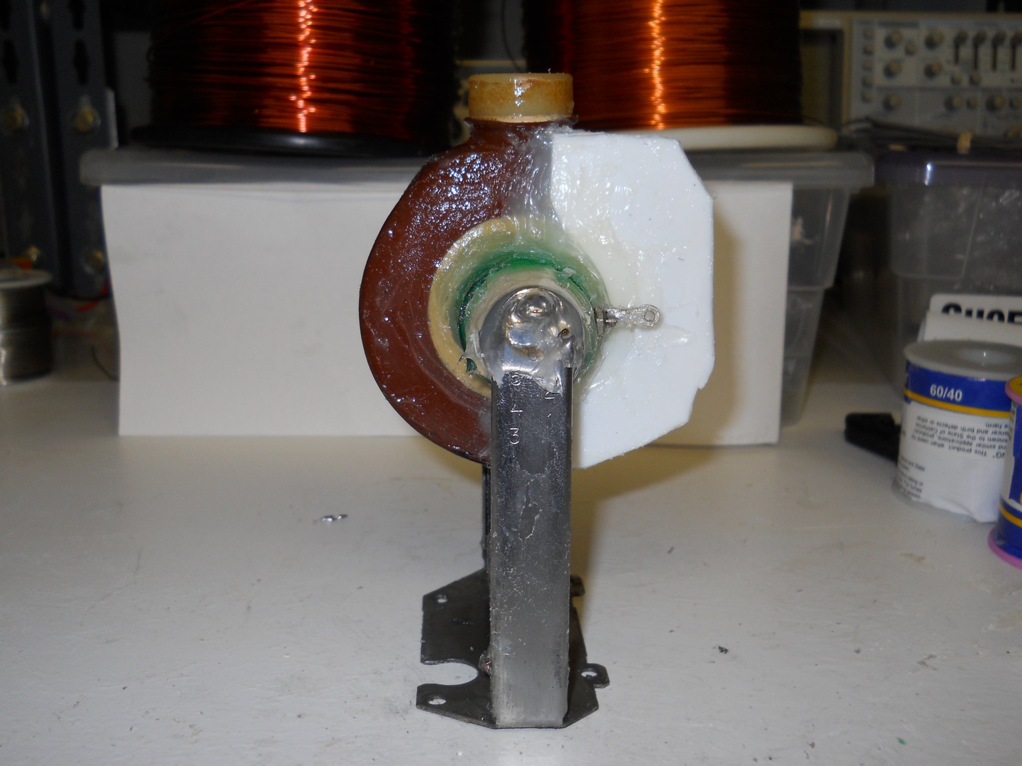

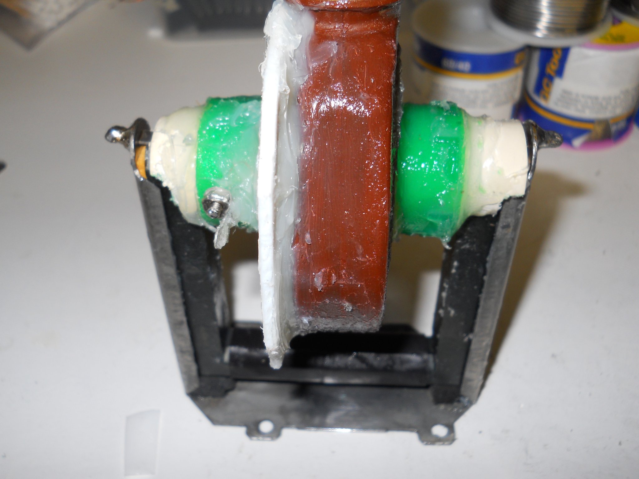

Step 2-15) Install lateral insulator
Tasks:
1)
Form a cardioid of 0.093" (AKA "93/1000'ths") PTFE sheet stock as per item #1 in the image (immediately below):
2)
Size, shape and fit the insulator to the EHT winding assembly in a manner consistent with the following images but do not apply adhesive at this time.
Note that the insulator must be trimmed to closely fit the shell and extend beyond the peripheral aspect of the EHT winding by at least 1 cm.
3)
Having properly formed the insulator, 'de-gloss' one side of same using '00' grit emery cloth/paper.
4) Apply liberal quantities of electronics grade RTV silicone to the appropriate surfaces of the EHT winding assembly and the entirety of the 'sanded' side of the insulator.
5) Attach the insulator to the EHT winding assembly as shown in the above images.
6) Apply an excess of electronics grade RTV to the exposed side of the insulator and adjacent areas of the EHT winding assembly...
7) Distribute the RTV over the insulator and EHT winding assembly surfaces such that an interlocking bond is established.
8) Position the LOPT 'insulator up' then allow at least 48 hours curing time.
