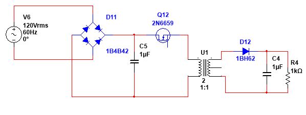

Hi, I'm designing a flyback converter in where a MOSFET not connected to ground must be driven. Please check the following circuit:
The MOSFET needs to be on the high side and could be n or p (preferably n). The duty cycle of operation goes from 0% to 95%.
Could a pulse transformer be used in such a high range of duty cycle?
I'm NOT looking for a fully integrated IC (Mosfet + driver) solution.
How to start-up the power supply? a driver with HV source current?
Whatever thoughts you have on this are appreciated.
Thanks

You cannot organize the Q12 in that way. Reason - main transformer will become oversaturated, or gap will be huge. For solve this problem exists half-bridge or H bridge circuits.

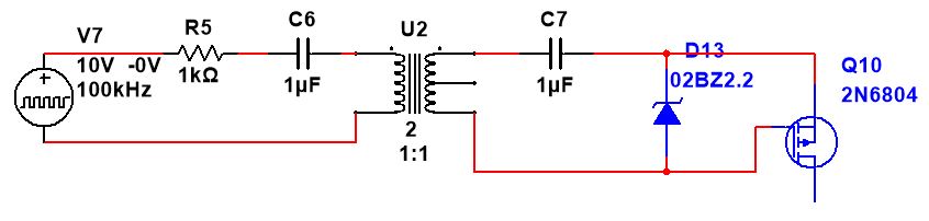

You're better using a Pfet mosfet with the Drain to the pulse transformer.
Hi, thanks for answering, something like this (forget about component values)?
Oh, I see, I have both windings in the same orientation or the diode reversed. This is more like a forward converted without the 3rd winding.

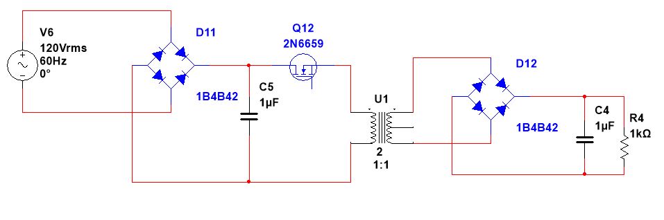

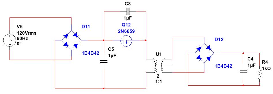

On a flyback configuration if I use a full bridge rectifier in the secondary, will I get a bit more current out of the same core, by getting current out of the secondary in both ON and OFF state of the switch?:
Would a ZVS forward configuration have more power density than a flyback one?

Actually I am surprised to hear of ZVT/ZVS in the context beyond the at least 50 000 Watts, and so more about buck/boost or any other non-HBridge converter (probably the lack of my experience?). Never say `never`, but I feel it like the cannon trying to shoot the sparrows.
