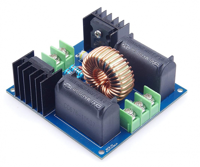

does this zvs module make high voltage
danadak
Joined Mar 10, 2018
4,057
The listed specs seem to indicate it generates HV, but then
description refers to it as a driver board. And terminal connections
do not seem they would support HV w/o arcover.
Regards, Dana.
danadak
Joined Mar 10, 2018
4,057
Cap ratings 1200 V ? Looks like it reading top of caps under magnification.
My bet still on no to 10 KV or 20 KV coming out of this board.
Regards, Dana.
ericgibbs
Joined Jan 29, 2010
18,766
This is a review from the one user comment.
Contact the seller to confirm its operation,
