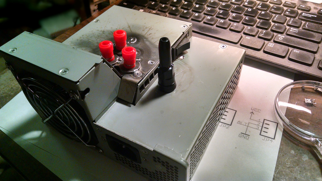

Hi All,
I am currently working on turning an old ATX power supply into a 12, 5 & 3.3v power supply. It will have plenty of current but was thinking about something like this http://www.12volt-travel.com/5-amp-12-volt-power-supply-p-4819.html , a couple of LM317's and some banana jacks. I was looking at the slightly larger one with 10amps but I really don't need that much power. Well I guess I don't need it yet. Anyways, my question is really - how well would this type of power supply work with LM317's to get 5 & 3.3v?
Thank you, John

I would stick with the ATX supply. They have plenty of power on each voltage rail and make a nice project. Also, you can always find one in a dead desktop from an electronics recycling day.
Trying to use LM317 for anything more than 500 mA means heat single and fans. Especially since you will be dropping 7 volts or 8.7 V to get to 5 and 3.3V respectively. Multiply those voltage drops by the current you want and that is the wattage that the poor little LM317 must deal with. No worries with the ATX supply.

I desolder all of the extra 12, 5, 3.3 and ground wires from the board. Then the box opens up quite a bit for cooling without all the wires there. I use a fat piece if stranded wire (gauge depends on end use). Sometimes I add a little project box to the top so I have room for Banana jacks. Sometimes, I just add the LED (power) and LEd(standby) and a switch - then run my power to what ever I am powering with no jacks.
Here is one.

I went with an ATX power supply. It looks like shit, but it's great. I thought I had plenty of banana jacks. I reality I had only two. So I went ahead and drilled the required holes and then went to buy more banana jacks - they had only small jacks. So I had to make the holes smaller using washers and a mig welder. :smiley-sad:
12v ~ 7.5a, 5.5v ~ 14a, 3.3v ~ 19a. Perfect!
