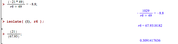

I get R6 = 67 Ω and Ic4 = 0,309 A
I haven't used the given gain information yet. Q4 provides no additional gain, it is Q1, Q2 and Q3 providing the necessary gain. So I have to find a correct gain formula for the first two stages? This gives me a second equation. I already have the first equation:
21,7 V = (2,95 / R4 ) * R5.
I have the DC current (3,65 mA) and the collector resistor (2000Ω) for the first stage. How can I find the corresponding gain A1?
A=A1*A2=100 . From this I can derive the necessary gain A2 and the required second equation for R4 and R5.
When I have two equations involving R4 and R5. I can solve it.
62Ω is a standard resistor value from E24 series. Which means that you cannot buy a 67 ohm resistor.
