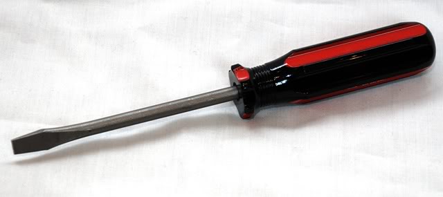

Get appropriate tools:
1 miniature flat blade screwdriver
1 small flat blade screwdriver
1 medium flat blade screwdriver
After you have the necessary materials wait for further instructions.

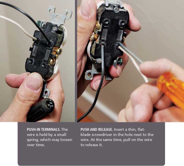

How to replace the receptacle
If the bare copper ends of the WHITE and BLACK cables are wrapped under the screw heads then skip over this next step.
If the WHITE or BLACK cables are inserted into a hole on the back of the receptacle, you have to release the cables with the tiny screwdriver.
You push the blade of the tiny screw driver into the rectangular slot and pull the cable out of the hole.
Make a note of how the old receptacle was wired and install the new receptacle in same fashion.

A couple of points to note: The power to the outlet was connecting using the two wires into the back of the device. The old outlet had a strip of electrical tape wrapped around the side, covering the screws on the respective sides. Is there any reason I would need to wrap the new one with electrical tape?
