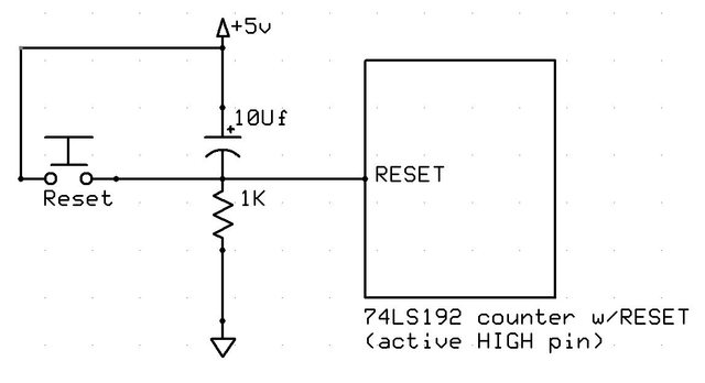

Critique my circuit for chips with RESET pins

I'm using a 74LS192 DECADE counter which has a RESET pin on it. I've come up with a simple circuit that seems to work just fine for now. Should I be concerned that my switch effectively shorts out the capacitor? We're only talking 5 volts at most here, with pretty low capacitance, but still....

Should I be concerned that my switch effectively shorts out the capacitor? We're only talking 5 volts at most here, which pretty low capacitance, but still....
You have a valid concern. The shorting of the capacitor will create a spark and cause premature failure of the reset switch contacts.
The solution is simple. Just place in series a resistor with the reset switch of any value between 10Ω and 100Ω as this will then reduce the short-circuit current to a safe level for the switch contacts.

True, but wouldn't the concern then be that as the capacitor charges/discharges, it will have to pass through TTL's undefined input voltage zone of .8 to 2.0? Theoretically there could be problems...but probably not.
If the pin is a gate input, then undefined input voltage zone will cause problem as the gate output might change state unpredictably.
For undefined voltage on a reset pin, it could also cause multiple resets but since what reset operation does is to force the chip into a well defined state so multiple resets will effectively changes nothing after the first reset.
