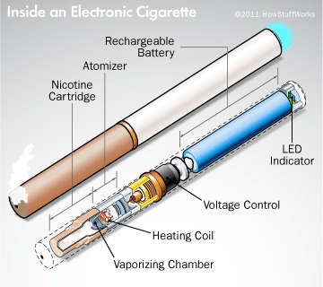

    Have you considered researching e-cigarettes? They faced many of the same design challenges. Small form factor, sufficient battery source to provide heat, providing enough heat to vaporize liquid... How do E-cigarettes work
    [​IMG]
    ebeowulf17 and Michael Cibene like this.
