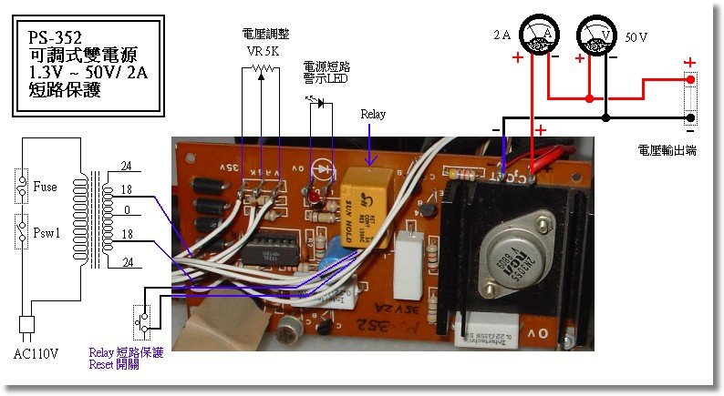

ScottWang
Joined Aug 23, 2012
7,509
You didn't attach the schematic, at least draw a block diagram to show how the power wiring, the following is a Power kit that I built it for a long time, because the circuit of board is not my design, so I only shown the diagram and wiring.
