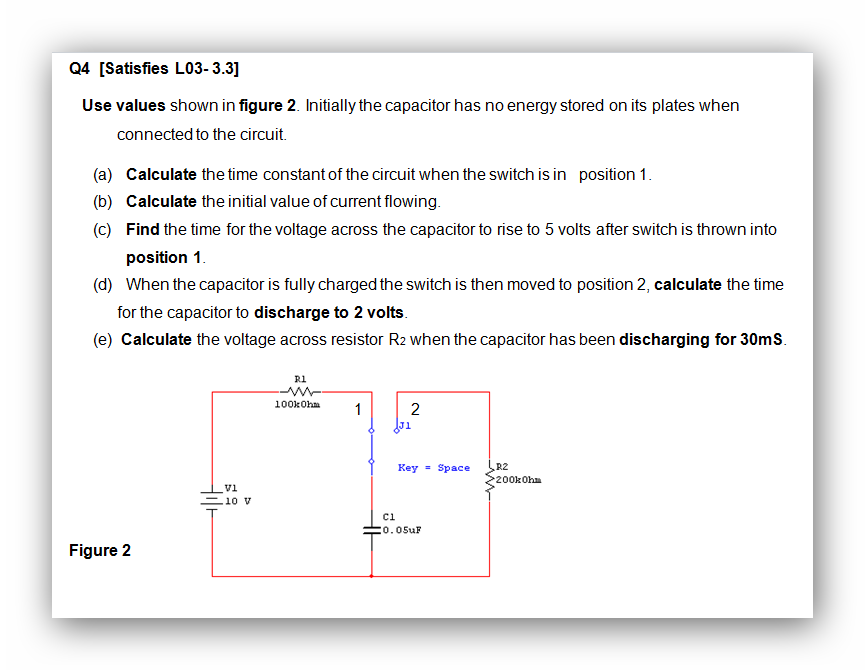

Sorry it's the third uploaded picture that I think we're the issues lie, I'm fairly confident on a,b and c parts of the question and its parts d and e were I think I've gone astray. I've posted up the question from my assignment and then the attempts at completing it. I'll try and put arrows to the offending items later when I'm finished work.

This is the assignment question im working on.
