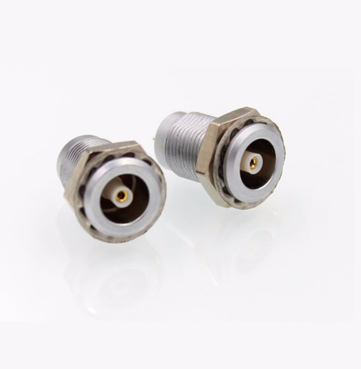

I've got the following "lemo" plugs, which I am fairly certain are the S-series.
This datasheet shows some fixed sockets which I'm interested in, but they are all around $30/each.
Would it cause too many problems if I simply soldered the pins to some wires...
I'll be damned if I give those greedy gatekeepers any of my inheritance money!
https://www.mouser.com/datasheet/2/232/unipole_multipole-973098.pdf (S-series Pg.73)
To be honest, I don't even think the manufacturer of this part used genuine lem plugs. They don't have the logo.
I'm fairly certain these are what I'm looking for

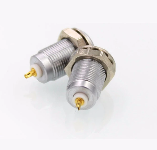

One thing I'm confused about is where I'd solder the ground/signal pins to on the back of these female sockets. There's just that one gold piece.

hi mb,
You have marked the pins on the images as Pos and Neg, if it is really only a power plug, I would solder the wires as you propose.
If its HF/Vid etc signals, I would buy a low cost connector pair, male/female and replace both.

The plugs go to a transducer which carries a 100ns pulse at 220V. There are two cables because it is a dual element device. One cable carries the input pulse, the other receives any sort of sound that is reflected backwards towards the probe.

When you say replace the connector pair, are you suggesting I take the fake lemo connectors off, resolder something from Lowe's onto them?
ericgibbs
Joined Jan 29, 2010
21,439
hi mb,
I am having a small problem with posting today.:mad:
If its only DC wire, connect directly by soldering.
If its HF signals buy a low cost pair of connectors, not lemo's
E

MisterBill2
Joined Jan 23, 2018
27,513
There is a company name UDO that makes a number of LEMO compatible connectors. They are less expensive and provided me with good customer service a few years ago.
The really terrible news is that once you solder to the pins on those expensive connectors they will be totally useless.
So I suggest that you cut them off, leaving about an inch of cable to allow neatly unsoldering the cables when you get the mating connectors eventually, and solder on some standard BNC connectors made for that sized cable. BNC connectors are made by many different companies and are often available as surplus items as well.

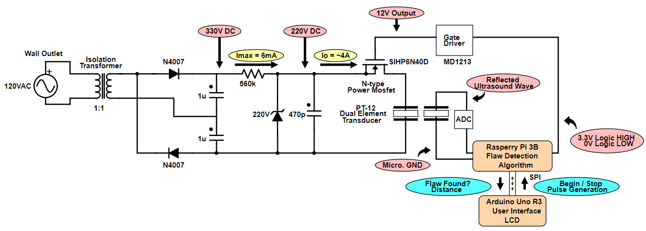

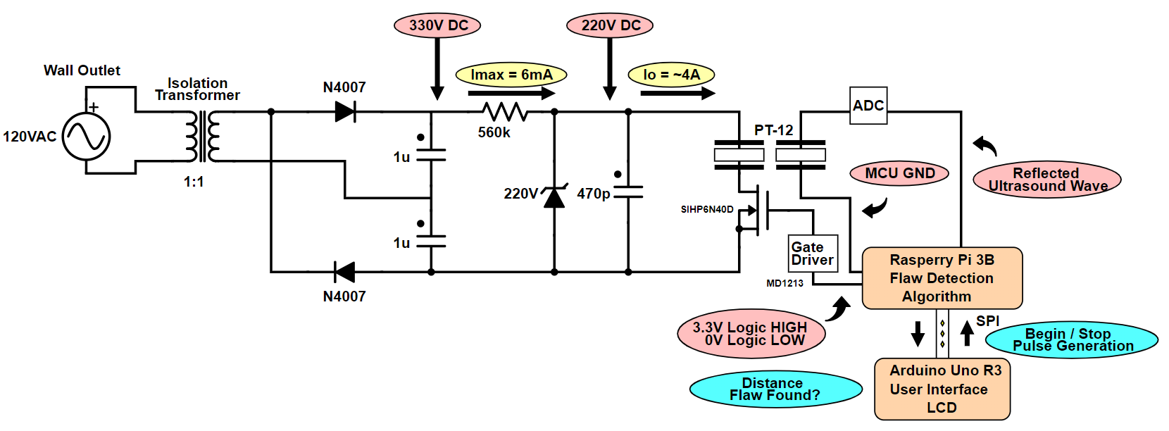

mbferguson
Joined Apr 23, 2017
94
I've also made a schematic that is a bit more legible than my hand drawings. I'm unsure about which location for the mosfet will be best, which is why there are 2 schematics shown. I've heard conflicting views from both my professor and another professional about which of theses circuits will work. The schematic shown above has an issue with the mosfet gate source being at 220V. That means that Vgs would need to be at 230V to activate the gate. My idea was to simply flip the mosfet horizontally, so that Vgs = 10V from the gate driver would still enable the mosfet. I was told that would not work by one, and told it would work by another. Both of whom I have reason to believe know what they are talking about.
Part of the reason I asked about the current calculations in the comment above is due to the 2nd schematic. I am worried that since the transducer will actually be attached to the 220V node it would never be able to resonate as efficiently if the mosfet immediately shut off the voltage being the case shown above.
MisterBill2
Joined Jan 23, 2018
27,513
The second, (lower) circuit should resonate a little bit better because once the mosfet switches off the thing will be isolated from ground, and the opposite side will be at a higher impedance point than the first, in which one side of the transducer is solidly grounded. In addition the driver should be simpler because of not being so far off ground.
