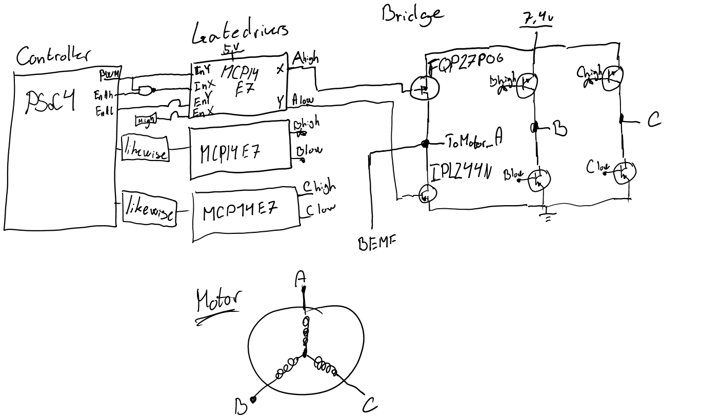

Currently i am running a project where we are supposted to control a BLDC motor (to run a skateboard).
Anyway. Our bridge and control is running (supposedly) correct, since we can run the motor in open loop.

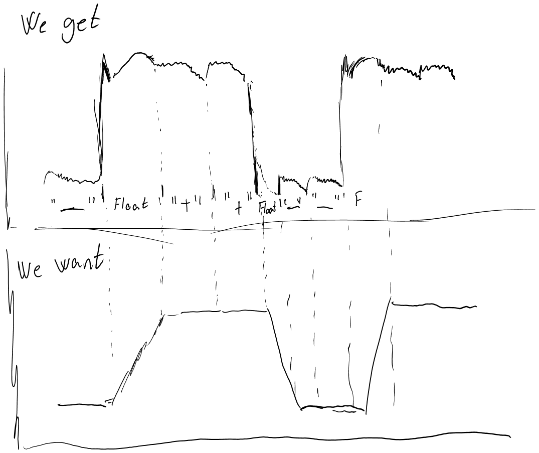

Now to control the commutation we are looking at our BEMF signal, which unfortunately is looking incorrect.
I do not have any chance to upload the actual oscilloscope pictures, but I can draw it quite decently.
The picture below shows how each of the A, B or C BEMF looks like. This signal is Not very easy to calculate a zero-cross from.
I can get Scope-pictures tomorrow of everything you might want, to be able to help me.
Hopefully you have an idea of what could be wrong.

I assume you've built a circuit to generate this signal, and you want help in making it work. We cannot guess the architecture of your circuit without a schematic, thus we would not be able to help debug it.

Sry Bout' that, i thought that maybe someone would have encountered the same problem. Our design is here:
I can see that the N-Channelmosfet didnt catch my pen right, so here are the components:
P-Channel MOSFET: FQP27P06
N-Channel MOSFET: IRLZ44N
Gatedriver: MCP14E7
Nand: 74hc00

Concerning the drawings of you scope traces in post #1. Why would you think the top trace (bemf) should be like the bottom one, which looks like the trapezoidal wave form that drives the motor phases? After being exposed to the inductance and capacitance of the motor coils, do you really think the 'scope traces will be the same? :)

We have been looking on some different application notes to get some ideas of how to meassure where to commutate. From bemf it should be done from detecting the zero-crossing. In all the notes i have been looking on so far, the bemf looked likehttp://ww1.microchip.com/downloads/en/appnotes/00857a.pdf, page 14.
I have attached the Bemf from the application note.
For some reason ours dont look like it. It might just be us not understanding the curcuits i dont know :/
