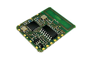

Hi John,
By "I can't get them to work" I meant I can't make one module sending data to the other one.
What I did up to now is to setup the modules in simplex comm, one as TX and the other one as RX and transmitted low speed serial data (1200-2400bps) for tests.
On the TX one, I have connected a FTDI USB/Serial cable and send data. ON the RX module, I've connected my scope watching for any signal on the RX pin.
But up to now, I see nothing "transmitting".
I must miss something, but what. I triple checked the cabling, changed breadboards, got two cups of coffee but no better result up to now.
Is there any way to check things step-by-step and, for example, make sure the TX is really sending something?
A few days ago, I found somewhere on the web a guy saying that these modules are "so transparent" that one can use them as morse transmitters since he apparently connected a button on the TX side sending +0,6V or 0V signals and a scope on the RX side. Weird... Can this be true?

Yes, I first built up a "wired" circuit, tested and because it was okay, I replaced the wires by the modules.
By "simplex" I mean I send data only from A to B, never from B to A.
And "yes", I can clearly see data going out (and in if needed) from my FTDI cable.
I don't think there is a cabling or data problem. My feeling is more around the modules themselves...but what is it?

Okay,
I've just received two new modules and guess what, it works now.
I think, I've made so many different tests that I must have fried one of my first modules, the "receiver" one.
Stupidly, I didn't think about swapping both modules because I would have then noticed that a lot of garbage comes in even if the transmitter doesn't send anything.
Thanks again for all your ideas ;-)
