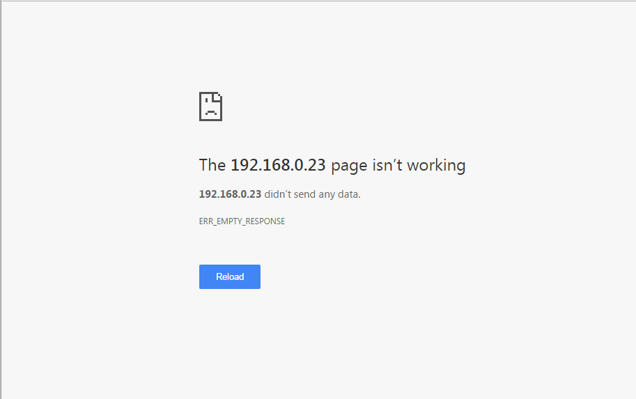

I used this Arduino Wifi sample code which is similar to the other code in what it attempts to do:
https://www.arduino.cc/en/Tutorial/WiFiWebServer
The code works fine. In the Programmer's Serial Monitor I see the following:
Attempting to connect to SSID: "my network name"
IP Address: ###.###.#.##
signal strength (RSSI):-83 dBm
But when I use the Arduino Wifi Shield's IP address in Chrome the Programmer's Serial monitor it continues with:
new client
yclient disconnected
new client
GETclient disconnected
new client
client disconnected
Edit: Fixed above link

Ethernet is not a stateful protocol. What you are seeing is exactly what is expected, depending on what packets the code communicates.
Why your message disappears depends on your code. Instead of posting what the code is based on, post your code

After uploading the output in the Arduino IDE serial monitor was consistent. Once I tried connecting by entering the Sheild's IP address in Chrome's web browser it did the same as before:
"new client"
"client disconnected"
Elektrishun
Joined Dec 27, 2016
66
No.
The serial monitor shows that I tried connecting when entering the IP address in Chrome but the page itself shows following:
There was only one occasion where I got a brief glimpse of the alarm code before seeing the above result directly after.
djsfantasi
Joined Apr 11, 2010
9,237
What is your problem? I see two. One, you cannot connect to your PC. Second, your alarm code does not work. Is this correct?
I have been addressing the latter.
For the former, I will make some general comments. I can't see yet why you are not sending the HTTP response. I had a couple of thought, but couldn't support them. I might insert a serial.print immediately before you send the HTTP response.
Your screen shot indicates that the browser is not receiving the HTTP response. Let's find out why!
