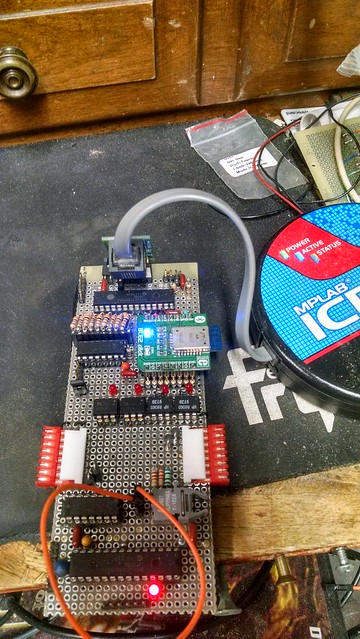

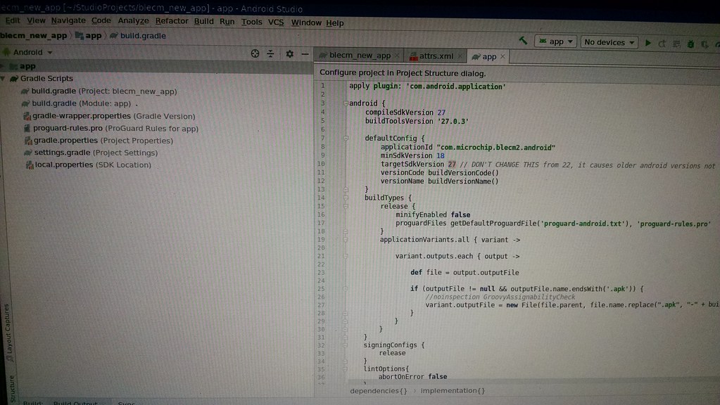

Sure there's a way, it's just not simple to do something cool.
My old BLECM2 Android app for the PIC24 BLE board still works with the latest SDK and API's but I'm limiting the version to 27. Once you get past 27 and enter AndroidX the world changes.
https://developer.android.com/jetpack/androidx
https://github.com/nsaspook/blecm_new_app
This app
connects to this board via BLE using custom characteristics.
https://forum.allaboutcircuits.com/threads/pic24-bluetooth-low-energy-dk.128497/page-2#post-1060969

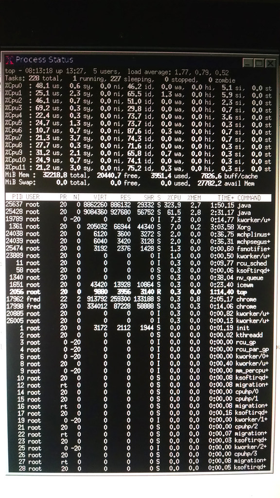

It helps to have horsepower while compiling apps.

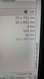

Hi,
Very interesting. I have 8 cores and it still takes something like 30 seconds to build a small project. Myabe it is because of low memory.
