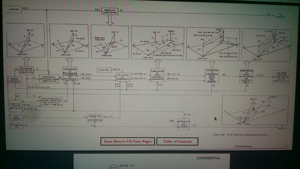

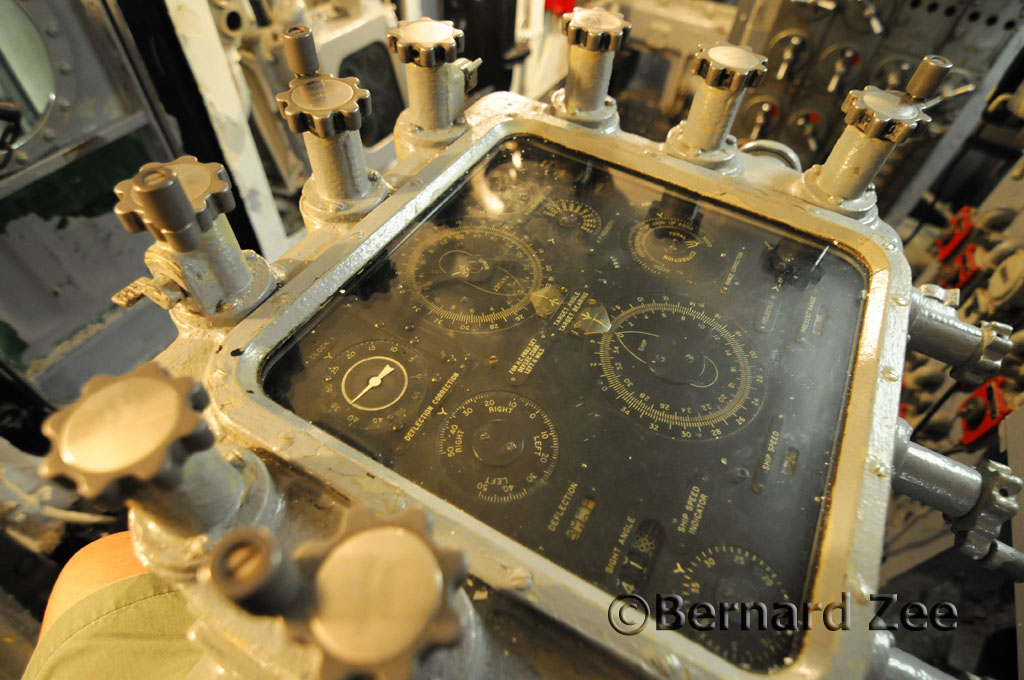

Cool stuff. Back in the 80's the fire-control 'analog' electromechanical computers for the BB-62 class ships were still operational for generating a firing solution (20-plus variable calculus problems in real-time) for targets. The MK-1A I believe was still there but primary control was given to modern computers during the upgrades to feed signals in the system. We installed the ships data processing mini-computers. http://www.eugeneleeslover.com/ENGINEERING/OP2074.html
Mk 47 computer
https://en.wikipedia.org/wiki/Rangekeeper
7 total videos about fire-control computers.
