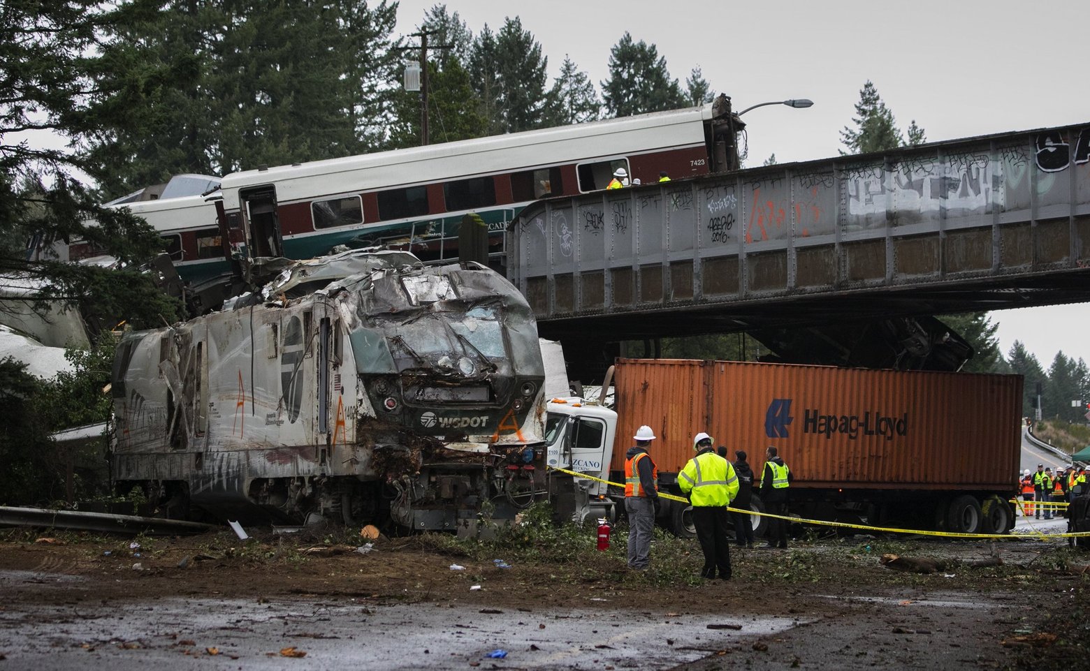

The tail engine.
Front engine.
Looks like that engine took out a few trees before stopping on the road.

That is a puzzling crash. The tail engine and a fair amount of cars rode track up to bridge. But the front engine and some cars had to leave track.......before where the tail engine stopped. One heavy engine went thru.....but the first engine didn't. AND it looks like engine left track before sharp part of turn.
To a layman's eye it looks like excessive speed for that curve.
The one car behind the front engine (next to the semi) looks really badly damaged.

I see what you mean.....that was the sharp part. Maybe the front engine tried to slow and back engine pushed it off.

That photo explaining the trees.........I bet the guy driving the semi pooped his pants when he saw that locomotive jump out of the bushes.

At the moment it appears that there are two stories behind the accident. One being the train was going ~80MPH in a location that it should have been going 30 due to poor/missing track speed signage or indication devices or operator error and two being antifa is claiming to have sabotaged the tracks by pouring concrete on them.
