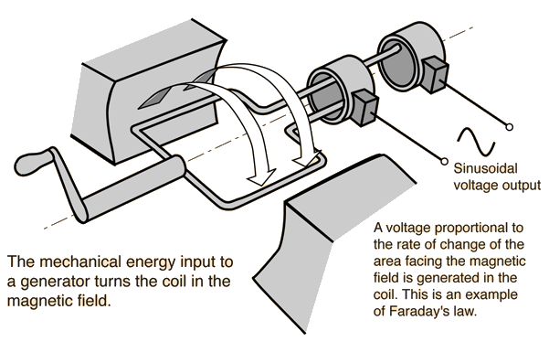

Can you visualize an alternating current generator moved by say a hydroelectric dam with its two output wires pushing and pulling electrons ?
Can you visualize those two wires as a transformer primary input ?
Can you visualize a centre-tapped secondary of the transformer someone named it 'neutral' ?
Can you imagine the alternating pushing and pulling electrons happening at the terminals of Na secondary, no matter what connection may be done to them ?
Well, that transformer can be like the one hanging from the power pole near your house.
And its three secondary wires passing trough your power meter and then feeding your electric stove, wall outlets...
Between "+" and neutral you get 120VAC. Between "-" and neutral you get another 120VAC. Between "+" and "-" you get twice that, 240VAC
If someone decides to connect that 'neutral' wire to ground, nothing happens to the supply; just neutral gets connected to earth. Which also makes 120VAC also to ground, not just the neutral.

I have no trouble following your diagram. It looks pretty clear. But the problem still remains. First of all one wire is hooked up to the dirt/earth. I am surprised that the Earth/dirt is a conductor like it is a copper wire that is for sure. To me, it would look like an open circuit. And if I sit here and tell myself to deal with it, the Earth is obviously a conductor wire. Now I am left with two more problems if not more. By definition it should becomes the current-carrying conductor halfway through each cycle, Alternates in that coil of the transformer, no? If not, it would mean it is not AC. If it does alternate we have a dangerous issue of the ground being a live wire.
And let's suppose that the ground is some sort of return and does not alternate at 60 Hz which would make no sense due to the reasoning of AC system. The problem is still there. it would be equivalent to walking on a current-carrying wire in all instances.
Furthermore, if we assume that earth is not really a path to real strong current, then we got major issue of high resistance.
Am I the only one that asks these questions and what is so not obvious that no one would ask what I have just brought up as a matter of immediate inquiry? My questions to me stick out like a sore thumb. And I have never seen anybody actually directly ask them instead of getting all lost in all kinds of technicalities and word bamboozlement, engineering jargon. :)
Birds walk on high voltage conductors carrying high currents all the time because there is low potential between their feet but people have died from ground potential rise that caused a lethal voltage between their feet during a lightning strike.
You need to stop just looking at current. It's the potential from point A to point B that matters into X resistance for power that matters in any instant during the 60 Hz cycle.
IMO you need to eventually see AC as a energy wave vector rotation in time and space instead of just a 2D projection of sine wave current. The engineering jargon is not something you can dismiss because until you understand it you won't really GROK electrical energy.
The actual direction of the electron or ions in the conductor don't matter as electrical energy flows between both wires (including the earth if it's a current carrying conductor) from the source to load.
