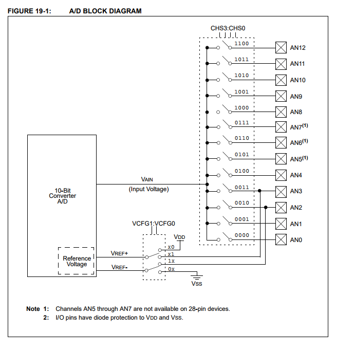

Alright so doing MOVF ADRESL,W gives me a blinking led (0x01) but when I turn around the potentiometer nothing changes.
Also using right justified and then adresl would give me 0-7 right? I checked this picture

If you go to the PIC manual http://ww1.microchip.com/downloads/en/devicedoc/39631a.pdf
and then search for adcon0, adcon1, adcon2 you can see the configuration.
Now I don't know if I've done mine correctly, the thins is the potentiometer has a value of 0-255 how would I set it up to give me a value of 0-7
three bits.
thanks

So I'm using PORTE since the Porta is used for the A/D conversion.
LesJones
Joined Jan 8, 2017
4,543
Can you post the full schematic of the LED matrix including showing the current limiting resistors. What does the strange picture mean that looks like cross between a matrix display and a 7 segment display ? Can you confirm that you are using an LED matrix not a multiplexed 7 segment display ?
Les.
pStrafe
Joined Jan 24, 2018
10
Iatic of the LED matrix including showing the current limiting resistors. What does the strange picture mean that looks like cross between a matrix display and a 7 segment display ? Can you confirm that you are using an LED matrix not a multiplexed 7 segment display ?
Les.
The cross thingy is just illustration. It's a 8*8 matrix LED.
Also the schematic with resistors is in the attachment. HL-K18 check that (bottom righ)
