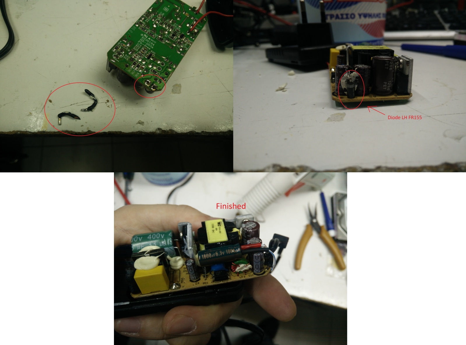

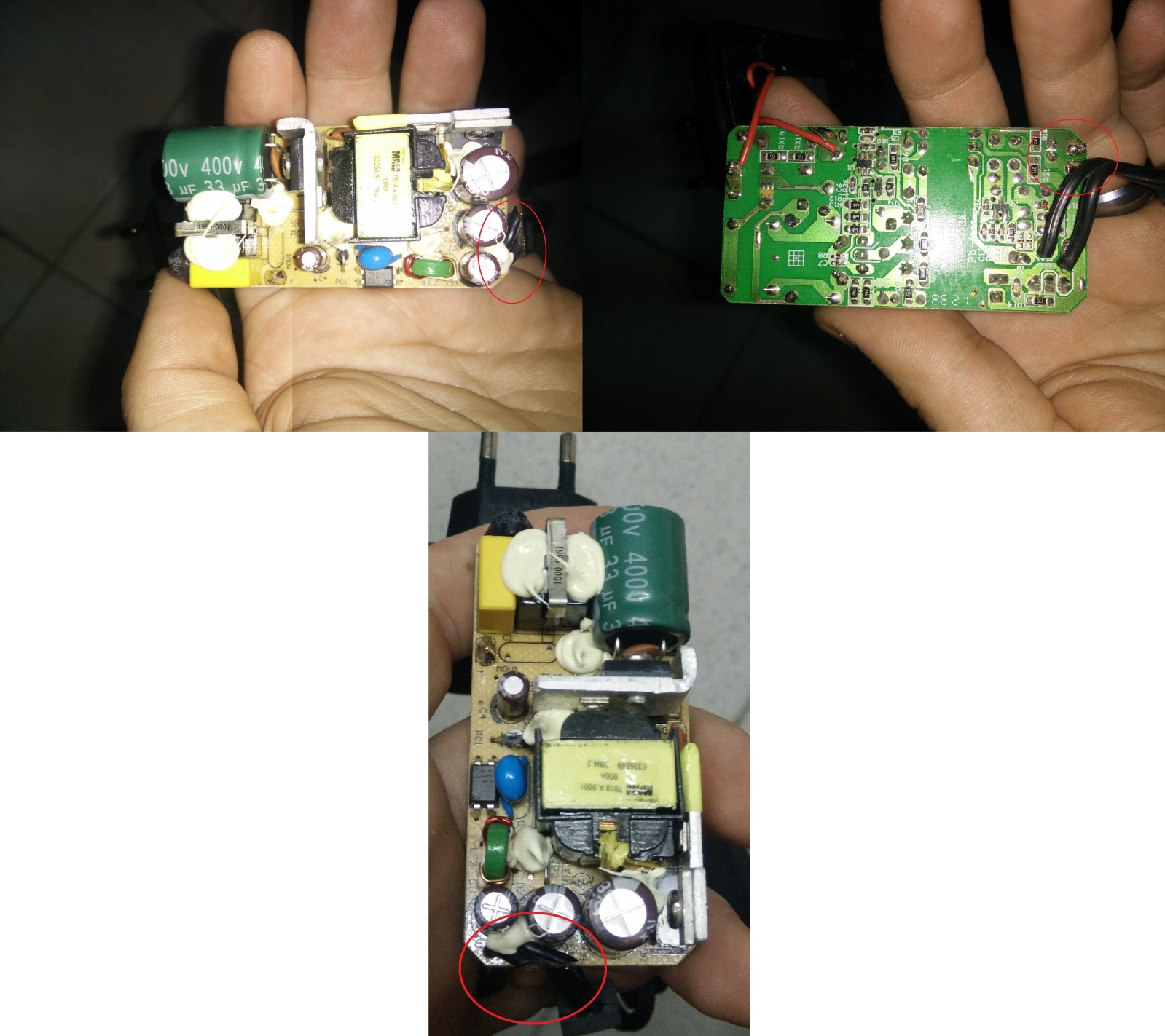

Check 1st post I've got some pictures there(quality wise ...sucks)
With the LH FR155 diode the voltage is 5.10v we're good(I've changed the cables to the proper location-where the board was suppose to output the voltage, not where the Chinese guy put the connections - check 1st picture)
EDIT: so final results
How it was(Before):
Where u see circles is where the board has the output(Chinese had it on a capacitor rather the the board output circuit - don't know why)
And how it's after my mods:
About the capacitor I had some laying around, it's big alright but it fits so I really don't care :p - I'll test it in an old phone today and see how it goes(if it's capable of charging it, it won't burn anything for sure)

what are the IC's on each of those AL heat sinks ?? is that small 4 prong dip a fuse of some sort. whats that 400v cap for? just because you measure 5.1v doesnt mean so much, need to see what it looks like on scope, etc. my cheapy Harbor Freight palm sized 12vdc/120vac inverter measures ~120vac on my Fluke DVM, but on scope the 120vac is horrible shape and causes my laptop power supply to run hot. i think you understand my points, so be careful to what you are powering with this supply, etc.
and to note, it went from 5.44v to 5.1v with diode ??

Ye I get your points, that's why I'm not gonna test it on my primary phone(but my second in command :p)
Yes 5.44v -> Diode -> 5.10v
