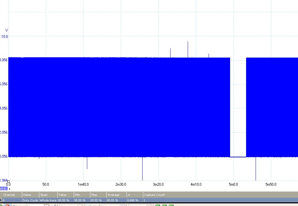

Since my last post I have built the 14541 part of the circuit. There is one thing about it that I forgot: on power up it resets itself and starts the timer as if you have pressed the reset button.
In any case, with a 0.047 uF capacitor it runs for about 3 1/2 minutes and with a 0.1 uF cap it runs for 7 1/2 minutes so a 0.068 uF cap should be pretty much 5 minutes.

One more thing to be aware of is that its output goes high as soon as you take MR high but it does not start counting until MR goes low again. So it will let the 555 run for 5 minutes plus however long MR stays high.
Is this and the fact that it runs once at power up a problem?

Im just waiting for mosfet and driver, Ive done the rest but have a small problem. when I connect power it starts straight away, after the 5 min time it will start again when I connect pin 6 of the MC14541 to feed, Is there anyway to make it start only when pin 6 (SW1) is connected
Thanks
antonv
Joined Nov 27, 2012
148
I don't think there is any way to prevent it from running once at power-up unless you hang some other logic around it to disable the output for that first time only.
What do you mean by "connect pin 6 .. to feed" ? How exactly are you using pin 6?
