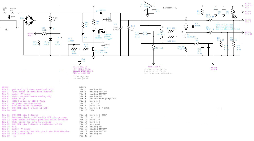

restricying the current to a motor

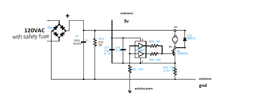

I see an Arduino connected directly to the AC mains- a very dangerous practice.
Use an isolation transformer.
The format of the circuit is not the best.
But as far as I can see, Arduino is not connected to mains. They are sourcing 5 volts and providing ground from Arduino, but that is for circuit that comes after the rectifier.
tom_s
Joined Jun 27, 2014
288
Without transformer isolation, or optical isolation, it is a death trap!

Alec_t
Joined Sep 17, 2013
15,155
The Arduino ground is only one diode drop away from mains potential, Shteii01!

MikeML
Joined Oct 2, 2009
5,444
Do I need to use a transformer?
YES, YES, YES
First, read this Wiki, which discusses the power distribution grid. There are differences in different countries, but this description likely covers your specific situation in your country...
I have prepared the following diagram and simulation. The box on the left represents the Electrical Distribution Grid. I show it as a 230V AC voltage source, one side of which (doesn't matter which) is referenced to earth ground. This is intrinsic in your country's grid. All voltages shown are with respect to earth ground.
Look at the voltage at the node "hv" V(hv), green trace. Note that is always positive. It is a half-wave rectified wave, with a peak voltage of 325V (1.414*230V). Now look at V(arduinognd), red trace. Note that it is the mirror image of V(hv), but delayed by 180 degrees. Finally, look at the current that flows through R1, I(R1) blue trace. It is as you expect, the normal full-wave rectified waveform.
The reason that this circuit is a death trap is because the instantaneous voltage on the ArduinoGnd side of the circuit goes to a peak of -325V. Imagine that you have the USB cable plugged between the Arduino and your computer. Now either of two very bad things can happen:
All desktop computers I have ever worked with have a direct connection from their metal box to earth ground. This is shown in schematic as the dashed line. The USB plug 0V pin is connected to the computer's metal box. The instant you plug this in, there will be a huge explosion, with a huge current flowing through the Arduino, along the USB cable, through the computer to earth ground. You will blow something up...
If your computer is a laptop, which might have a transformer-coupled isolated power supply, you may avoid the explosion described above, but you have now connected the exposed metal parts (d-sub shell, video connector shell, modem cable, usb cable, network cable, phone line, touch-pad) of the lap-top computer to -325V.
If there are any grounded peripherals plugged into the laptop, chances are they get back to earth ground some other way, and you are back to the explosion. If nothing touches earth ground, then the metal parts of the laptop, and all thing plugged into it are hot... Imagine your kid coming to use your laptop to play a game...
Sorry to be blunt, but if I have to explain this to you, you have no business playing with transformer-less, off-line circuits...
