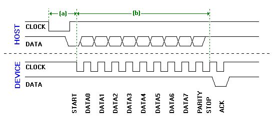

one more question we receive data from keyboard can we send data also to keyboard but what the use of sending data to keyboard from PC, i am confused with tutoial.

In the case of the reference you gave, almost the first thing I saw when I looked there was "Furthermore, the keyboard interface allows bidirectional data transfers so the host device can illuminate state LEDs on the Keyboard."
Here at Allaboutcircuits, you're asking "what the use of sending data to keyboard from PC". So now I have to wonder, is this a guy who reads his reference material, or is he someone who just won't do any work? And if he asks for help, do I want to offer any?

A thing I am puzzled about. The PS2 Keyboard communication uses a synchronous serial protocol. And hence the PIC UART should be set to work in synchronous mode, with the keyboard providing the master clock. Are you using the PIC UART in synchronous mode?
